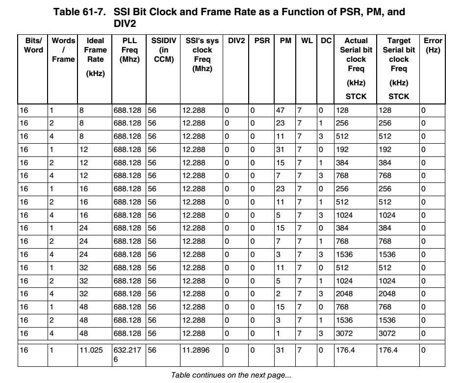

codec works in slave mode, ssi  generate the  sclk and  frame clock .
the sys's clock is 24M,  i follow  the nex table to configure registers :
Table 61-7. SSI Bit Clock and Frame Rate as a Function of PSR, PM, and DIV2.
but  bit clock and  frame sync clock  dnot work correctly .
how can i call  function imx_ssi_set_dai_clkdiv according to the sample_rate and sample_format?
Do you have relevant document or  demo to introduce  the configure ?

       I  need to configure the i2s clock  in kernel ,not in  app。
      ssi  works in  master mode。
       how can i configur  the ssi‘s register according to  the sample rate and date format.
      in  machine driver (imx-sgtl5000.c)  。
    thanks a lot。

I do not think that this is possible thorugh some simple
register settings using "imx_ssi_set_dai_clkdiv ", as alsa subsystem configures
it using own apis.
Please check attached in previous answer linux manual and
look at sources in Table 7-1. Stereo Codec SoC Driver Files
For better understanding probably may be useful to look at baremetal audio tests
Github SDK (/drivers/audio)
https://github.com/backenklee/swp-report/tree/master/iMX6_Platform_SDK
