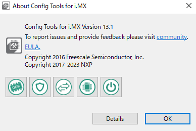

How can I configure a pin as Open Drain for i.MX7D using the config tool?
I was unable to find the option to configure it.
Also, please tell me how to configure it as an interrupt PIN in the same way.
I use Ver 13.1.
