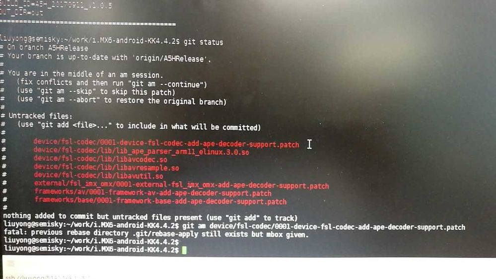

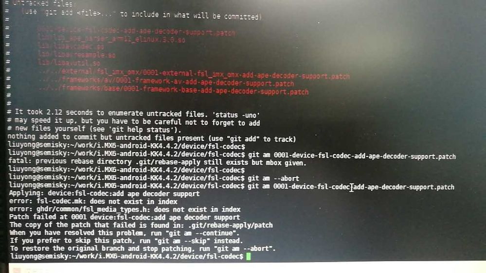

I got the i.mx6 android 4.4.2 ape patch from NXP FAE. But i cannot apply the patch on KK4.4.2. Here below is my installation steps.
1, install the OMXPlayer Package and build the image with the instructions of codec release note.pdf.
2, cp lib_ape_parser_arm11_elinux.3.0.so libavcodec.so libavresample.so libavutil.so  ~/myandroid/device/fsl-codec/lib/
3, copy file 0001-device-fsl-codec-add-ape-decoder-support.patch to ~/myandroid/device/fsl-codec, then run command $ git am 0001-device-fsl-codec-add-ape-decoder-support.patch
but i received the errer message "fatal: previous rebase directory .git/rebase-apply still exists but mbox given". I googled the related the use case, but still unfixed.
Please adverse me how to fix it.

The APE codec is free, so i think no need license. The patch can be applied on M6.0 directry. I checked the patch file. I'm quite sure it's not for kk4.4.2. But NXP China FAE said it's for the KK4.4.2. Finaly i modified or created the MK file, source file and head file followed the instructions of the APE patch. And i built the Android image with no error. After flush the new images, the Music player pop up the error dialog with "The player doesn't support this type of audio file".
Now i have two questios for curren status.
1, If the patch i'm using is for M6.0, can i apply it on KK4.4.2?
2, If so, how can i fix this issue step by step?
Plese advise me how?
1,399件の閲覧回数
hi_shawn
In addation, the 4.4.2 ape patch can be applied on m6.0 successfully.
