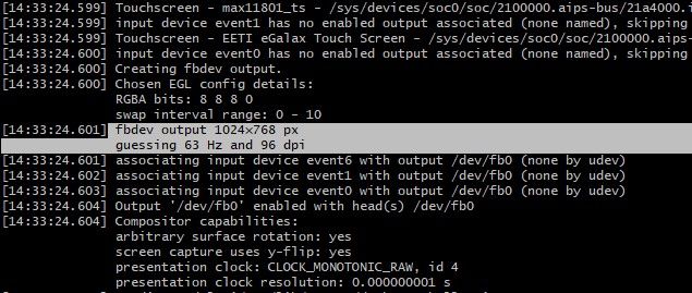

furkancanby
I found the device name at "/var/log/weston.log".
And I add these lines to  "/etc/xdg/weston/weston.ini" :
(My default screen size :1024x768 and 60Hz)
[output]
name=fbdev
mode=768x1024@60
transform=270
You can set "transform" 90 or 270 to use your display vertical.
Thank you.
