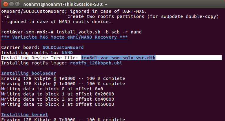

- If i want my custom dts, and change the name of the file during the command install_yocto.sh, how to process ? Because, if the file to flash NAND is imx6dl-var-som-vsc.dts and i want that it to be imx6dl-var-som-Maxime.dts for example, how to proceed ?

then i copy/paste the patch (time.patch.zip) from https://community.nxp.com/thread/492843 into time.c and it's ok ?  i rebuilt my dts, i flash my NAND et i can read frequency on GPT_CAPTURE1 ?
