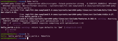

VinithNama
While Entering the make hello it showing make: ****No rule to make target 'hello'. stop.
3,296 Views
weidong_sun
Didn't you decompress Makefile.rar ?
