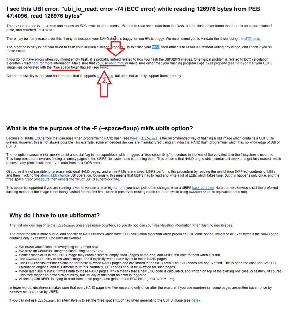

BiyongSUN
Gnana,
The -74 is very famous issue filed in MTD(Memory Technology Devices)
Could you please check the following link to see  if the issue is exactly you are facing.
  1. Have you used
    the ubiformat to flash the image to nand?
  2. If you don’t
    use the ubiformat, have you enable the “-space-fixeup”?
And it introduced two ways to fix it.
http://www.linux-mtd.infradead.org/faq/ubi.html#L_ecc_error

gnanachandrandh
Hi Devaraj,
Please find the patch for fixing bit flip in erased page. This patch has been in testing for past two days and were able to recovery units returned from field without disturbing their file system partition. Patch is also tested on the simulated erased pages that has less and more number of bitflips than set erase threshold.
Kindly share your review comments for the patch
Cheers
Gnana
