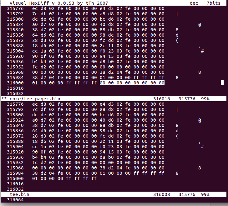

I'm attempting to load OpTEE on the MCIMX8MEVK board and am having an issue with the image loading.
The build process for OpTEE on https://source.codeaurora.org/external/imx/imx-optee-os/tree/core/arch/arm/kernel/link.mk?h=imx_4.9.... produces a tee.bin with a 24 byte header, and two more files tee-pager.bin and a zero length tee-pageable.bin.  The mkimage build process on https://source.codeaurora.org/external/imx/imx-mkimage/tree/iMX8M/mkimage_fit_atf.sh?h=imx_4.9.123_i... looks for a tee.bin and puts it into the fit unchanged. Finally the opteed_setup code in https://source.codeaurora.org/external/imx/imx-atf/tree/services/spd/opteed/opteed_main.c?h=imx_4.9.... assumes that there's no header and uses the binary as is.  This results in the processor attempting to execute the header block.
I can resolve this by using the tee-pager.bin file as the input to mkimage, but this throws away the header information. And will cause problems if data is moved into the tee-pageable.bin file. The change to handle this header has been available since 2014 in the Linaro-SecureWorkingGroup tree, https://github.com/linaro-swg/arm-trusted-firmware/commit/f6244e85df1d931e2ed6bd80e76fbf05a1b32f23#d...  which checks for the header and shifts the memory region.  In NXP's https://source.codeaurora.org/external/imx/imx-atf/tree/lib/optee/optee_utils.c?h=imx_4.9.123_imx8mm... there is code that reads the OpTEE header, but it is only used by arm_bl2_setup.c which isn't built using the current yocto recipes.

On i.MX8MQ the header is not included tee.bin when built with this script, the only difference between the tee-pager.bin and tee.bin is a padding at the end of the binary.
Currently, we are not using the OP-TEE header as you pointed in the link below.
