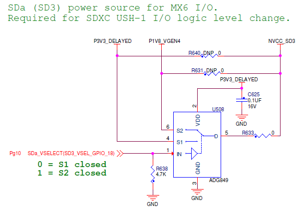

vincentchou
Hi!  Leo,
In that case, if we want to achieve UHS-I speed on our i.MX6 design, should we use the SD card circuitry on Sabre-AI instead?  Could we maintain the support of XD on the same card slot as well?
Vincent

vincentchou
Hi!  Leo,
I checked the circuitry on Sabre-AI and discovered it may requires a special version of i.MX6 with a change of internal FUSE content.
CPU Card Identification for Software
MX6 fuses OCOTP_GP1[15:8]
SABRE-AI rev C = 0x14
Does that mean we could not use this type of circuit with standard i.MX6 in our design?

TaniaMartinez
Hello Vincent,
Yes, you will need implement the Auto Board circuit. This works with the I.Mx6 with not auto qualification too.

vincentchou
Hi!  Tania,
Could we apply the same circuitry on all four SDIO ports on SABRESD board of i.MX6 EVB?  Could this be used with the consumer grade of i.MX6 cpu?  I was suspecious about this is because the following comments on the SABRE-AI board schematic
catches my attention.  If we design such a circuit with the standard i.MX6Q or i.MX6D, then should we apply some FUSE commands on the CPU first?  Could you also provide the mechanism of this circuit so we could know how to modify our SD driver code?  Thanks!

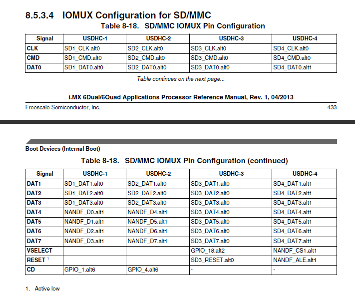

TaniaMartinez
Vincent,
This is the IOMUX pin configuration you will see on the reference manual. The Vselect option is implemented to USDHC-3 and USDHC-4 only. Yes, you will implement this solution on I.Mx6Q/D consumer grade. If you check the consumer datasheet you will found one reference on chapter 4.11.4.4.

TaniaMartinez

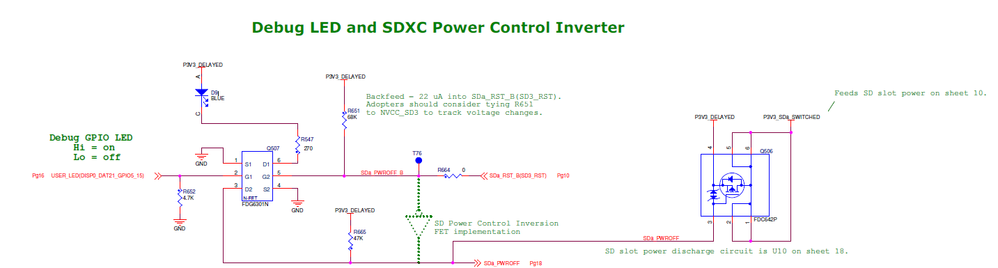

Only one comment, on the Sabre AI schematics we add a comment on SDa_RST_B(SD3_RST) circuitry. Take on consideration it.sabre ai.PNG.png

LeonardoSandova
Specialist I
Vincent, only Sabre AUTO boards support this type of cards. These have a circuit which does a voltage drop (from 3.3 to 1.8 V) so SD with behave as UHS-I. Last time I test on a 95MB/s card, I observed write speeds around 50MB/s. I tested on a 3.0.35 kernel version.
