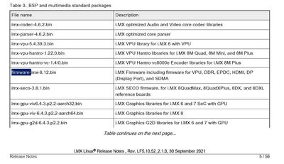

where can download HDMI firmware files to test?
kuda
Hi Kuda
https://www.nxp.com/lgfiles/NMG/MAD/YOCTO/firmware-imx-8.12.bin

Our SOM is the coral board, which linux kenel version is 4.14.98.
Your link address is for 5.10. Is the firmware is compatible?
And this firmware is set to decrease drive strength ?
kuda
you can find firmware version from Release Notes below for each BSP release
use https://www.nxp.com/lgfiles/NMG/MAD/YOCTO/firmware-imx-x.y.bin for download

We follow your example address and check i.MX Linux® Release Notes, Rev. L4.14.98-2.0.0_ga, 05/2019. We can download firmware-imx-8.1.bin successfully.
But we can't find any notes about HDMI firmware version control and HDMI drive strength control information.
How to check hdmi firmware version? We need HDMI lower drive strength to test and pass radio emission verification.
