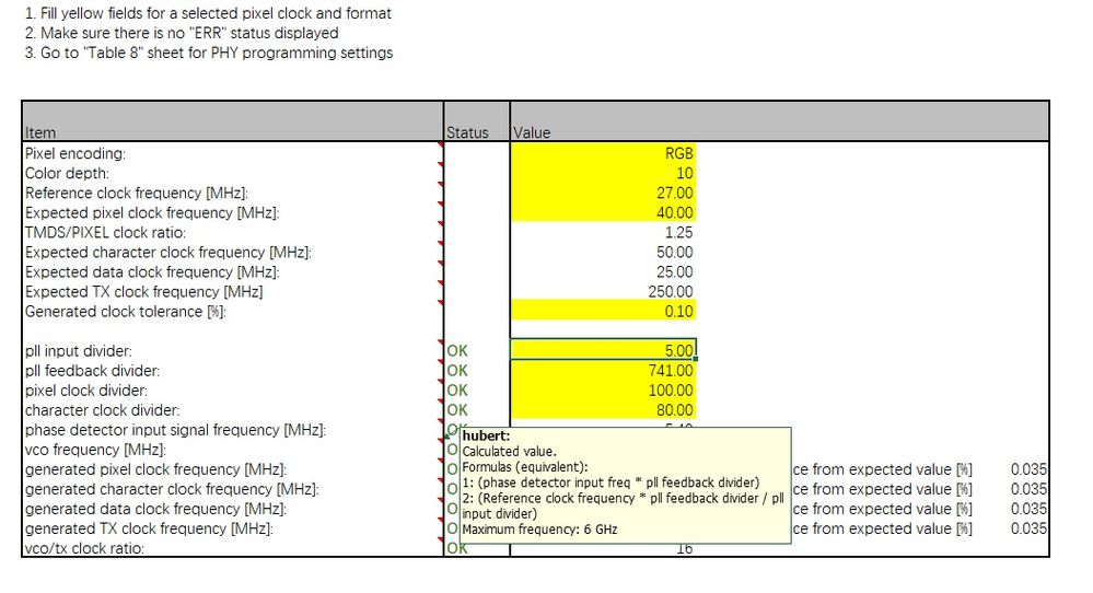

I have been messing with a bunch of the kernel parameters for the iMX8MQ and I was curious as to how to generate values for the HDMI TX table in the kernel->drivers->GPU->DRM->iMX->HDP folder because I need a rather specific timing generated for a nonstandard HDMI input. I am looking to generate a PIX-CLK frequency of 204_800KHz.

Hello Simon ,
Please see suggestions below, which comes from i.MX Expert.
The default BSP only supports standard HDMI clocks, but we can also add some more clocks.
It needs use HDMI - pixel clock calculation tools to generate the timing parameters.
you need calculate and fill the parameters in "Inputs" page of HDMI - pixel clock calculation.xlsx, if the parameters are avaliable, it will generate a new VCO item on t28hpc_hdmitx_pll_tuning_table_pixel_out.( drivers\gpu\drm\imx\hdp\API_AFE_t28hpc_hdmitx.c)
For example, assume pixel clock is 137.5Mhz.
{137520, 1000, 1374750, 0x03, 0x1, 0x1,  611, 0x1E5, 0x07A,  40, 0x012, 0x012, 5499000, 1, 2, 2, 2, 2,  687375, 0x2, 137475, 1},
I will send the tool to your email.

I managed to get a copy of the sheet. See attached. No idea if its still valid. My guess is that this is only relevant to the IMX8MQ since it references the 27 mhz reference clock instead of the 24mhz one used for the IMX8QM
