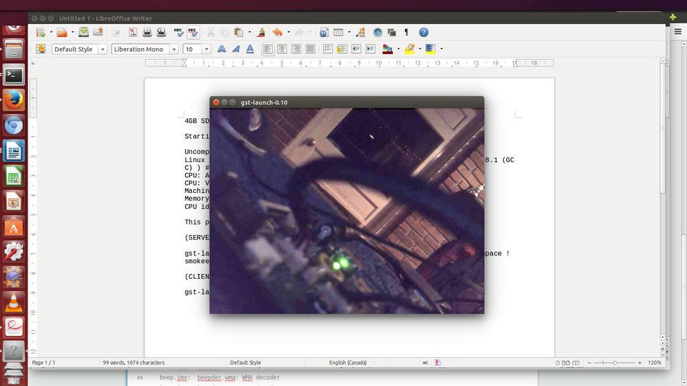

Might be difficult to answer, but any idea why I wouldn't get the gstreamer-0.10 window to pop open on my PC using these commands to stream video from i.MX6Q to a PC?   I don't see an error and looks like video is streaming.
I see setting pipeline to PLAYING on both terminal instances
Server:i.MX6 server  3.0.35-4.1.0+yocto+g5809938 fsl-image-gui
gst-launch-0.10 mfw_v4lsrc capture-mode=0 ! vpuenc ! tcpserversink host=192.168.40.63 port=5000 sync=false
Setting pipeline to PLAYING...
New clock: GstSystemClock
Client: Ubuntu 14.04 Notebook
gst-launch udpsrc port=5000 ! smokedec ! ffmpegcolorspace ! autovideosink
[INFO]  chromaInterleave 0, mapType 0, linear2TiledEnable 0
I expected to see a window like this, but nothing is popping up now.

I decided to re-build the fsl-image-gui BSP using the 3.10.17 kernel and the problem went away.
