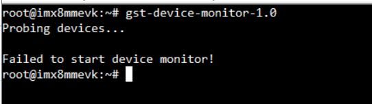

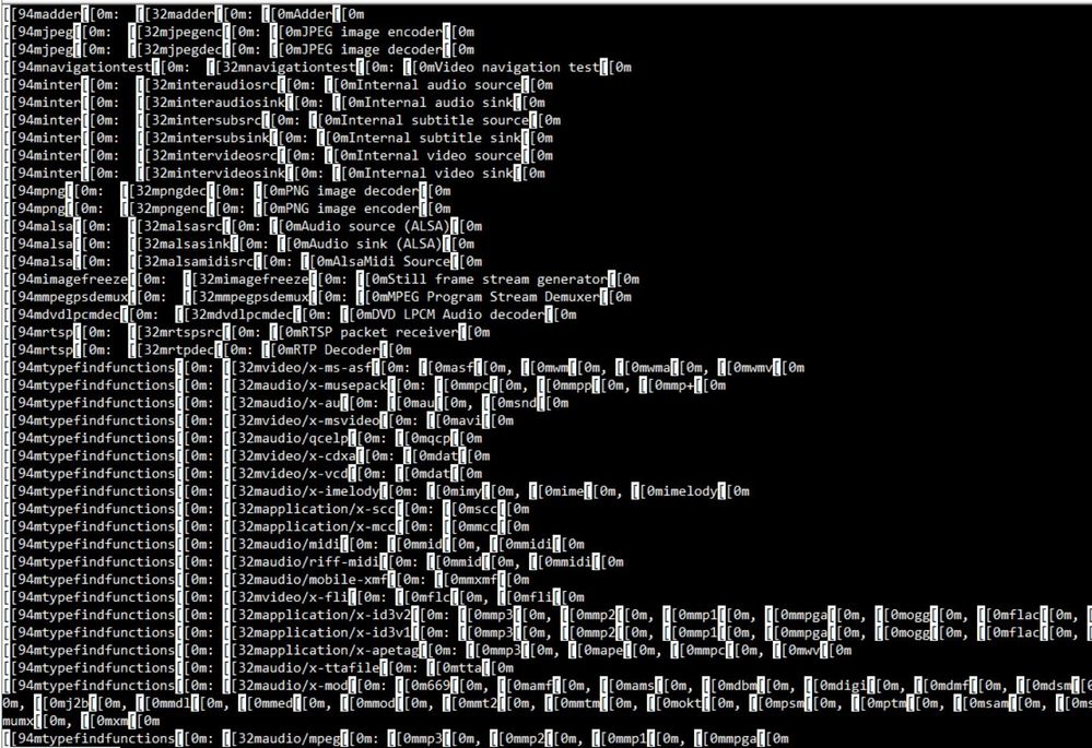

I am using imx8m evk with imx-image-core, in which while fetching feed from camera getting internal stream error from gstreamer.
Attached are the result gst-device-monitor and gst-inpect-1.0.gst-device-monitor.JPGgst-inspect-1.0-output.JPG

Adding packagegroup-fsl-gstreamer1.0 in imx-image-core.bb file resolves the gstreamer issue.

I am using imx-image-core , kernel 5.4.24 built using instruction provided by imx- yocto guide. It is working fine with imx-image-full.

Hi Erza
what bsp used in the case, one can try Demo Image  i.MX 8M Mini EVK
use Chapter 7 Multimedia   i.MX Linux User’s Guide​
