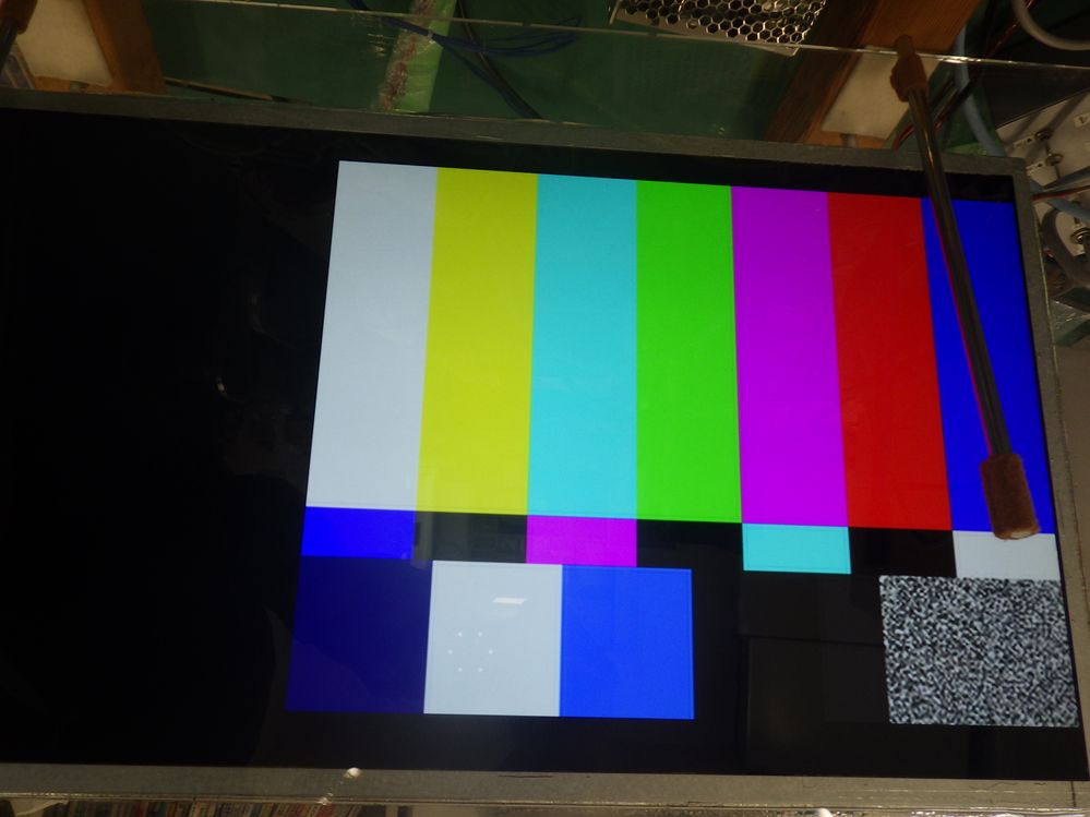

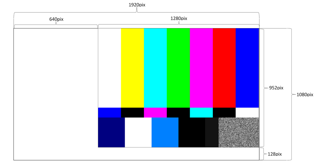

I'm trying to test Gstreamer on my imx8m mini board, but it's not working.
I would like to display a 1280x952 test screen on the upper right of a 1920x1080 monitor as shown in attached image 1, but the test screen is slightly shifted downward as shown in attached image 2.
Image1Image1Image2Image2
The pipeline used is as follows.
gst-launch-1.0 imxcompositor_g2d name=comp sink_0::width=1280 sink_0::height=952 sink_0::xpos=640 sink_0::ypos=0 ! waylandsink videotestsrc ! comp.sink_0
I would like some advice on how to improve this situation.

what shift do you mean? do you mean that your picture position isn't (640,0), like (640,20)?
6,259 次查看
KATA_KAN
Hi, joanxie.
That's right.
I want it to display at (640,0), but it actually displays as (640,20).
6,232 次查看
joanxie
it seems that waylandsink coudn't support this, you would get random postion
https://community.nxp.com/t5/i-MX-Processors/imxcompositor-g2d-window-positioning-with-waylandsink/m...
maybe you can try the ivi-shell, refer to the user guide:
IVI-shell
In-vehicle infotainment shell is a special purpose shell that exposes a GENIVI Layer Manager compatible API to controller modules, and a very simple shell protocol towards clients. IVI-shell starts with loading ivi-shell.so, and then a controller module which may launch helper clients. This shell provides option of setting windowing position, which need to be programmed from the client application.
