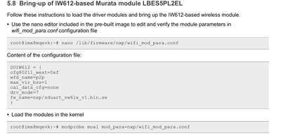

I am working on the i.MX93-EVK board. I flashed my custom-built image from https://github.com/nxp-imx/linux-imx using the imx93-11x11-evk.dts file to create the image.
While testing the Wi-Fi module, I am using the IW612 module.
when i following the above procedure i got an error like

root@imx93evk:~# modprobe moal mod_para=nxp/wifi_mod_para.conf
modprobe: FATAL: Module moal not found in directory /lib/modules/6.6.36-gd23d64eea511-dirty

You only update the Kernel image on the previous rootfs?
If yes,  the moal.ko file should be on the folder /lib/modules/6.6.36-lts-next-g4c96a79b2a7a/
The commands are taking the name of the new kernel and the files are saved with the name of the previous kernel.
