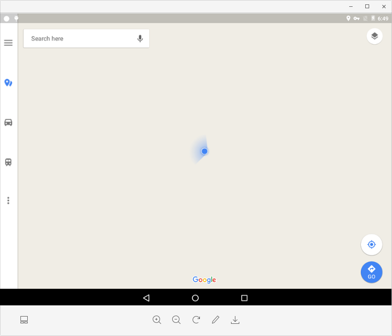

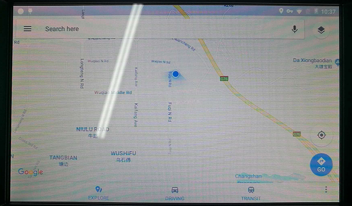

     We are using i.MX6DL/i.MX6Q with the same board running Android 5.1.1(Kernel 3.14.52) to run google map, but find that only i.MX6DL platform can show the google map while i.MX6Q platform can't, following is the failed picture(picture 1-1).

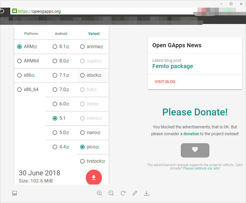

     1. Install the newest google frame; (picture 2)

     Picture 1-1  Failed to show the map
    Picture 1-2  Successful to show the map

Same problem whappen in IMX6q in Android 7.1.1...
But I tried to install 9.57.1, the satellite map and POI able to show. The road map still won't able to show.

And the OpenGapps built-in version(Latest version in 2018 Dec 12), it will not showing any layer of maps(Showing like Jimmy's image).

The most likely cause of the issue is that you use the OpenGapps package, that is not guaranteed to work on all Android builds, instead of the official Google Apps package. Try the later Android build.

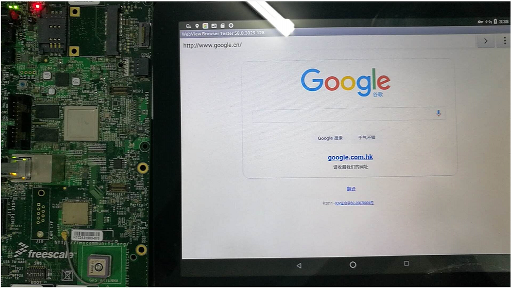

     As your suggestion, we tried android 5.1.1, android 6.0.1 and android 8.0.0, but found that i.mx6q still couldn't show google map in default mode, while i.mx6dl did.
    In android 8.0.0 running in i.mx6q, we can browse the google website.
    Is there any potential fault that we haven't taken?
    Hope your helps.
    Thanks a lot.
     Picture 1. google map failed to show in android 5.1.1/6.0.1/8.0.0
     Picture 2. In android 8.0.0, browsing google website successfully
