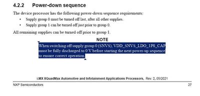

9,617 Views
igorpadykov
>This error I observed after sometime from power off to power on..
please check below requirement
igor
9,602 Views
vinothkumars
Senior Contributor IV
Thank you Igor for the reply.
Instead of power off the board I tried "shutdown" from command line and the device power off take sometime compare to normal on and off. but, still I faced same error.
And also I measure all voltage source all in 0 v only
