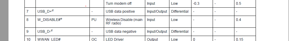

meanwhile, can I ask a quick question ? On the schematic for the sabre x board, there are 2 resistors connected to USB_HOST_DN and USB_HOST_DP, R177 & R178, they are zero ohm links, and they are marked DNP, so it means that to get USB over PCI working on the SABRE Solo X dev board these need to be fitted ? Is there any reason they are not fitted, will it cause problems elsewhere ?
Mahtab
1,427 Views
igorpadykov
Hi Mahtab
these signals are optional (according to spec for that connector) and it is
different from usb functionality provided by additional PCIe card inserted to that connector.
http://fit-pc.com/download/facet-cards/documents/PCI_Express_miniCard_Electromechanical_specs_rev1.2...
igor

msarwar
Hi Igor,
I'm back, I fitted those links and have made a bit of progress but not quite there. Now I get
usb 1-1: device not accepting address 4, error -71
usb 1-1: new high-speed USB device number 5 using ci_hdrc
kind of errors with the card. Also:
usb_otg1_vbus: disabling
Apparently error -71 usually means a device isn't powered, could that be anything to do with usb_otg1_vbus ? Although I thought the PCIe2USB controller on the SoloX was usb_otg2..still, do you have any suggestions what to do ?
edit: I can also see a
ci_hdrc ci_hdrc.0: there is a vbus glitch
in dmesg
mahtab
1,426 Views
msarwar
Igor,
Thank you, you've been very patient with me and the last document you sent looks like it's solved the mystery. From the card tech ref:
On the card, this USB_D+/ USB_D- are indeed different from the USB/PCIE functionality but still seem to be required for this card. I was worried that inserting the links would kill the usb otg serial console but I guess even if that happens otg can be configured differently to avoid any conflicts.
I'll have the links fitted and let you know how I get on ! My very best regards, enjoy your weekend ! :smileyhappy:
