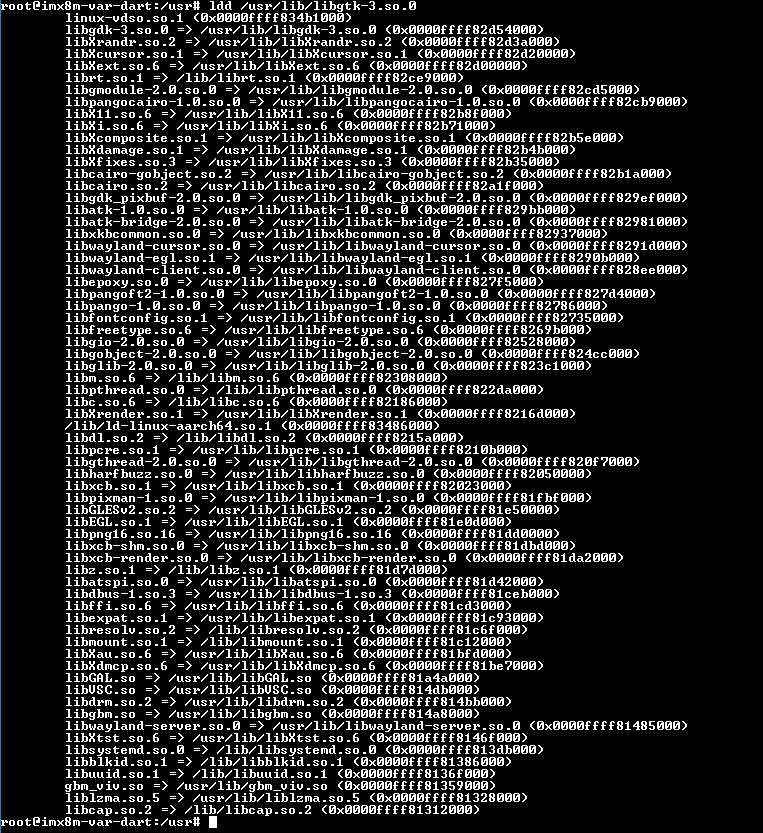

We are trying to run an application (Electron) that uses the library gtk+3 on the iMX8MMini on Yocto 4.14.78. We are getting an error “undefined symbol: gdk_x11_display_get_xdisplay”. This application runs OK on the iMX8MQ running the same OS version, but is throwing that error on the Mini.
Comparing the library dependencies for the library gtk+3 using the command “ldd /usr/lib/libgtk-3.so.0” on both the MQ and the Mini, we can see that the libgtk-3.0 library on the Mini has a much smaller dependencies list compared to the one on the MQ (attached images). Specifically, all the X11 backend was not included in the libgtk-3.so.0 on the IMX8MM.
Examining the run.do_configure file in the gtk+3 in the build folder, I notice that the the MQ version contains the flag "--enable-x11-backend" while the MM version contains the flag "--disable-x11-backend".

Can you please explain why all the X11 backend was included for the IMX8MQ and not IMX8MM? If this cannot be enabled, please suggest any solutions for this.

No, You need to check the file to disable-x11-backend none of i.MX8 have an X11 backend.
