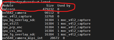

galcore.ko存放在/lib/modules/4.14.98-imx_4.14.98_2.0.0_ga+g5d6cbeafb80c/extra/目标下,在系统启动时,驱动galcore.ko已经被自动被加载到内核。如下图所示:
遗憾的是,装载该驱动后used by等于0,是不是没匹配到gpu device),gpu仍然不能工作!请问你还有其他方法帮助我解决这个问题吗?非常感谢!

Hello changshui,
The module is on and is not activated according to your image, you must run a graphics on it by example you can run the opengl unit test installed on your system, also you can run all samples for referring you can view the graphics user guide on your yocto documentation.
