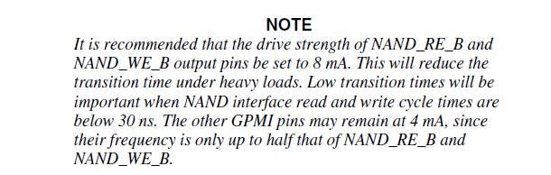

I have patched the code and still do not see much improvement. I am still getting random read error with DMA.
I have change the PAD settings for the NAND pins and are getting better stability with the NAND flash. But I still need to test for a few days.
I still need to try flashing a blank board with the new pad setting to see whether I am still getting the bad blocks on block0.

Also how do we change the drive strength for the pins?
I did not encounter DMA errors from NAND after changing the pad settings just need to understand the clock requirement of the gpmi interface.

22MHz is the clock rate for initial stage, the clock might be changed according to EDO async mode according to ONFI parameters. Refer to  gpmi_extra_init in gpmi-lib.c
To change the kernel pin drive strength were defined in device tree file.
Do you mind to show me which pad setting works stable for this NAND chip? Thanks.

Here is the PAD settings for GPMI.
pinctrl_gpmi_nand_1: gpmi-nand-1 {
fsl,pins = <
MX6SX_PAD_NAND_ALE__RAWNAND_ALE         0xb0a1
MX6SX_PAD_NAND_CLE__RAWNAND_CLE         0xb0a1
MX6SX_PAD_NAND_WP_B__RAWNAND_WP_B       0xb0a1
MX6SX_PAD_NAND_READY_B__RAWNAND_READY_B 0xb000
MX6SX_PAD_NAND_CE0_B__RAWNAND_CE0_B     0xb0a1
MX6SX_PAD_NAND_RE_B__RAWNAND_RE_B       0xb0a1
MX6SX_PAD_NAND_WE_B__RAWNAND_WE_B       0xb0a1
MX6SX_PAD_NAND_DATA00__RAWNAND_DATA00   0xf0b9
MX6SX_PAD_NAND_DATA01__RAWNAND_DATA01   0xf0b9
MX6SX_PAD_NAND_DATA02__RAWNAND_DATA02   0xf0b9
MX6SX_PAD_NAND_DATA03__RAWNAND_DATA03   0xf0b9
MX6SX_PAD_NAND_DATA04__RAWNAND_DATA04   0xf0b9
MX6SX_PAD_NAND_DATA05__RAWNAND_DATA05   0xf0b9
MX6SX_PAD_NAND_DATA06__RAWNAND_DATA06   0xf0b9
MX6SX_PAD_NAND_DATA07__RAWNAND_DATA07   0xf0b9
