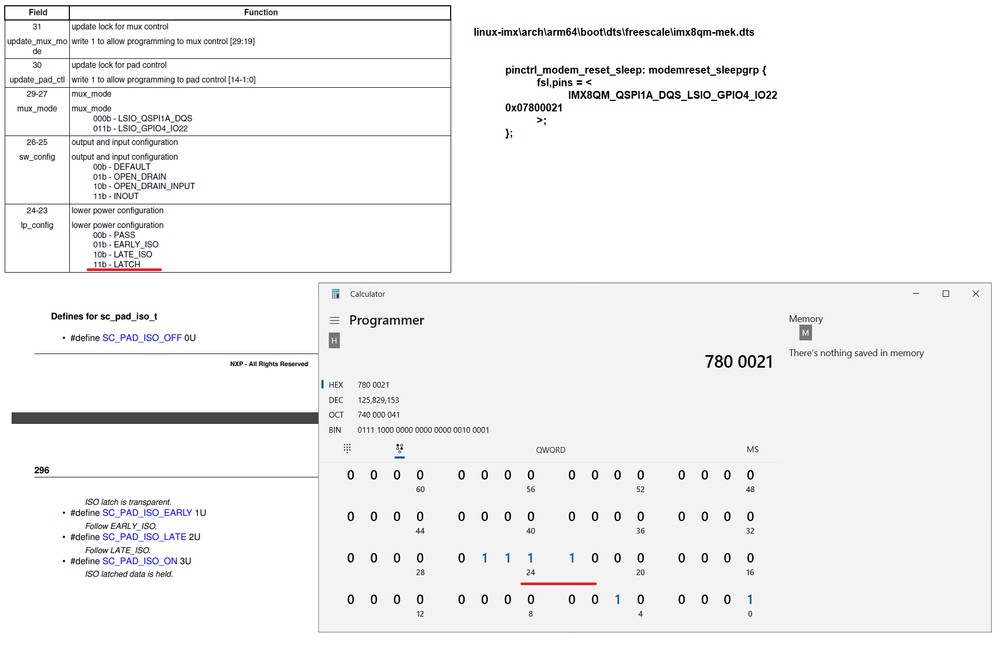

I have an enable pin connected to a peripheral that I want to maintain HIGH during normal mode and suspend mode ($systemctl suspend).
In the DTS:
IMX8QM_LVDS0_GPIO01_LSIO_GPIO1_IO05 0x00000061
Do you know how can I configure this pin to maintain its value when is in suspended mode?

Thanks, and if the register is different in suspend mode? How can I handle this?
Best regards.

Found one example in linux-imx\arch\arm64\boot\dts\freescale\imx8qm-mek.dts
And it matches the description in RM and scfw documents.
And LATCH should work, you can try it.
i.MX8QM has several settings in low power mode.
