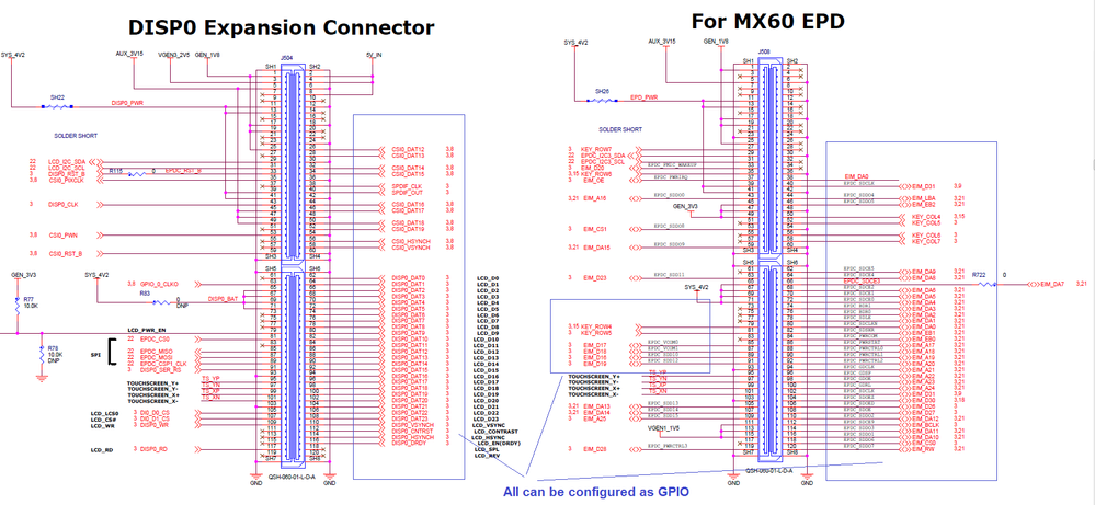

Does iMX6qSabreSD has GPIO port? If does, can anyone tell me where is the GPIO port on board?

Hi Yiling,
   On sabreSD board, there is no fixed GPIO port, but pins on these 2 connectors all can be configured to be GPIOs:
But you should bring these signals out of the connector by yourself
Have a nice day!

Thanks for your reply, but how can I configure J504 port as GPIO? Are there any reference?
