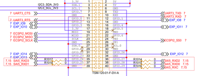

Where do i find gpio pin mapping details?
In schematic its mention GPIO.0, GPIO.2 but its not given gpio group details.
Please help!!

Only these gpio has gpio group, the EXP_XX is extended from gpio expander chip.

I am using libgpiod and it shows gpio group from gpiochip0 to gpiochip4. How to find gpiochip group of these pins?
