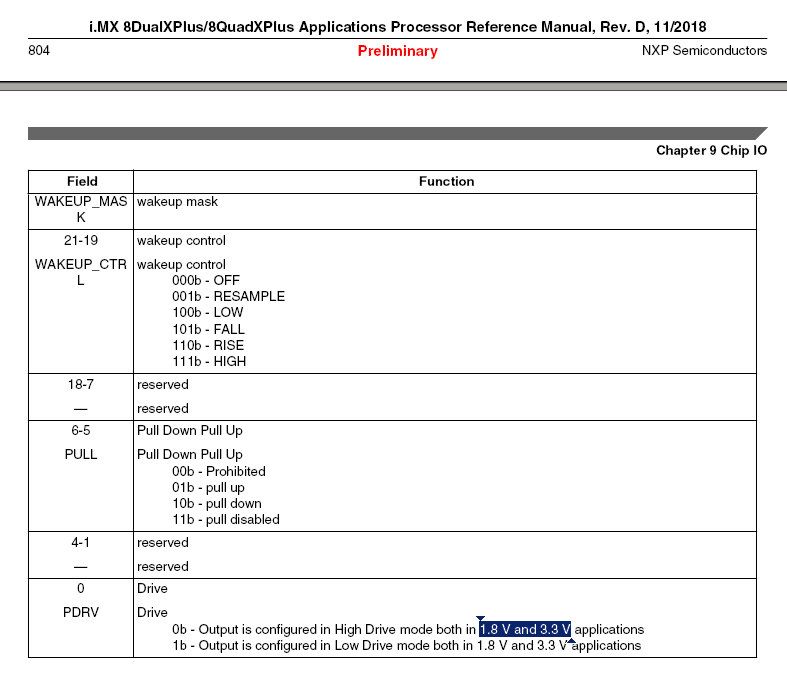

        The GPIO 4 configured to ESAI0_TX0 pad , GPIO 5 configured to ESAI0_TX1 pad  and GPIO 7 configured to ESAI0_TX2_RX3 pad requires IOMUXD_COMP_CTL_GPIO_1V8_3V3_GPIORHB  pad to be configured for toggling. But the GPIO 3 which is configured to ESAI0_SCKT pad still toggles without any extra settings. Even though all the GPIO's belong to a same pad group [ESAI0], each pins require different settings . As you answered some pads are dual voltage pads and some other single voltage pads. But basically these pins under this pad group supports 1.8 ,2.5 and 3.3 Voltage [VDD_ESAI_SPDIF_1P8_2P5_3P3] and our hardware team has fixed the voltage to 1.8 V for the 10 pins under this ESAI0 pad group.
So my question is , how one can identify the ESAI0_TX0,ESAI0_TX1,ESAI0_TX2_RX3 pads belong to dual voltage support pads and require IOMUXD_COMP_CTL_GPIO_1V8_3V3_GPIORHB pad to be configured while ESAI0_SCKT is single voltage pad?

igorpadykov
Hi Anjalik
for example for ESAI0_TX0 one can find RM description
indicationg dual voltage capability:
igor

anjalikkrishna
Hi Igor,
     This was the field I strongly hoped to indicate the single and dual voltage support .But I can find the PDRV field with 1.8 and 3.3v voltage support under ESAI0_SCKT pad too and ESAI0_SCKT  is a single voltage supporting pad according to the findings till now.

     I had gone through the chapter 9 of the reference manual and came across " Single voltage and dual voltage pad " .
     How can we identify whether the pad belongs to single voltage or dual voltage?
     I am still going through the reference manual for identifying the single voltage and dual voltage pads.
