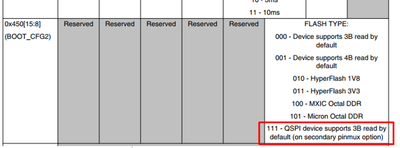

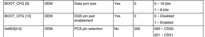

This issue is most likely caused by conflicts of the DQS functionality of this pad. Could you please share if you are using SEMC functionality to handle an external memory? What type of memory would that be? Also, please check the GPIO/fuse BOOT_CFG [10] (depending on if there is GPIO override or not). Is the "DQS pin pad enablement" on 1 or 0?
4,423 Views
sapirbuz
SEMC is used, and the external memory is NOR secondary, as in Picture 1.
BOOT_CFG[10] is configured as input GPIO, PU and keeper are defined as no init.
the DQS pins were left unconnected by HW.
At the beginning, DQS pins were enabled, but the MCU couldn't read the data from the boot EEPROM; so we disabled those pins.
Picture 1:

I am still looking into this issue. Could you please double check that the BOOT_CFG[10] fuse is still on 0 (unburned)?
It could be an issue that, during booting, the fuse selection of this pin is affecting its functionality, so we need to make sure the DQS fuse is not enabled on fuses for this pad.
