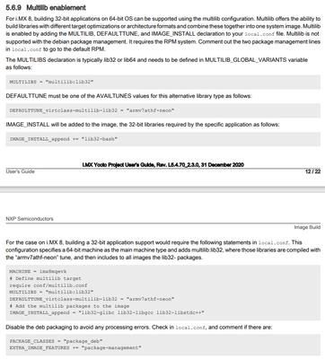

(1)I'm trying to building yocto i.MX8 32-bit applications on 64-bit OS.
(2)Reference L5.4.70_2.3.0 i.MX Yocto Project User's Guide
(3)I'm trying bitbake imx-image-full.
The error message is almost like this:
| ninja: build stopped: subcommand failed.
| WARNING: exit code 1 from a shell command.
ERROR: Task (virtual:native:/home/adv/adv-release-bsp-new/sources/meta-clang/recipes-devtools/clang/clang_git.bb:do_compile) failed with exit code '1'

Hi NXP Team
@Rita_Wang  We are follow the NXP "i.MX_Yocto_Project_User's_Guide".
In "5.6.9 Multilib enablement", NXP provide the how to add 32 lib in imx8.
But we still build fail.
Do you have any idea ?

Rita_Wang
For the 32bit application use on the 64bit OS, you need install related library.
