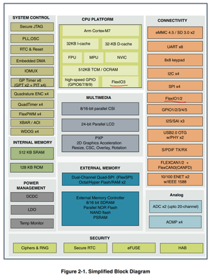

Hi, I am currently using FlexIO2 with eDMA on a few projects. So far it has all worked out very well. Yesterday I noticed this diagram in the document "IMXRT1060RM Rev. 3, 07/2021". It's interesting that FlexIO3 is shown here as tightly coupled with the CPU, while FlexIO modules 1 & 2 are located with the rest of the peripherals. I have not noticed any mention of this in chapter 50 on FlexIO.
How is FlexIO3 different than 1 & 2?
