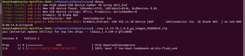

Hi All,
I downloaded demo images L4.14.78_1.0.0_ga_images_MX8MMEVK.zip
SW4 settings are
switch D1  D2    D3   D4
SW4 OFF OFF OFF ON
Attaching the screenshot for the same:
dmesg
[77087.606108] usb 1-6: new high-speed USB device number 98 using xhci_hcd
[77087.754953] usb 1-6: New USB device found, idVendor=1fc9, idProduct=0146, bcdDevice= 0.02
[77087.754958] usb 1-6: New USB device strings: Mfr=1, Product=2, SerialNumber=0
[77087.754962] usb 1-6: Product: SE Blank 865
[77087.754964] usb 1-6: Manufacturer: NXP SemiConductor Inc
[77087.757049] hid-generic 0003:1FC9:0146.001F: hiddev2,hidraw3: USB HID v1.10 Device [NXP SemiConductor Inc SE Blank 865 ] on usb-0000:00:14.0-6/input0
deepika@deepika-OptiPlex-3040:~/mfgtools/mfgtools/uuu$ ./uuu L4.14.78_1.0.0_ga_images_MX8MMEVK.zip
uuu (Universal Update Utility) for nxp imx chips -- libuuu_1.4.149-3-gf1c886b
Success 0 Failure 1
Prep 1/ 0 [========> 25% ] Http Download\Uncompress
1:6 1/ 1 [HID(W):LIBUSB_ERROR_NO_DEVICE ] SDPS: boot -f imx-boot-imx8mmevk-sd.bin-flash_evk
Can you please let me know the issue.

igorpadykov
Hi Deepika
recommended to try latest Linux 5.10.9_1.0.0 images as L4.14.78 is outdated release
https://www.nxp.com/design/software/embedded-software/i-mx-software/embedded-linux-for-i-mx-applicat...
Also what board used in the case, as " i.MX8MPEVK demo image" should be used for i.MX8M Plus EVK
and "L4.14.78_1.0.0_ga_images_MX8MMEVK.zip" with i.MX8M Mini EVK.
igor
