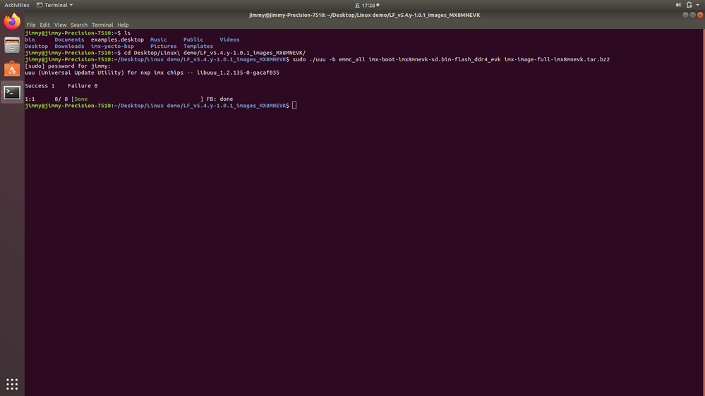

I am trying to flash i.MX8M Nano EVK using UUU Tool on Ubuntu 16.04. I have configured boot switches to Serial Download Mode and connected USB cable and Power. I am giving following command:
$ sudo ./uuu -b emmc_all <bootloader file .bin> <rootfs file .sdcard.bz2/*>
And I am getting following error:
uuu (Universal Update Utility) for nxp imx chips -- libuuu_1.3.191-5-gbb8cda8
Success 0 Failure 1
1:2 1/ 1 [HID(W):LIBUSB_ERROR_TIMEOUT ] SDPS: boot -f <bootloader file .bin>

rohan_mathuria
Sure!
  1. Set the board to Serial Download Mode by configuring switch SW1101 to 1000
  2. Connected board to computer through USB Type-C cable connected to Serial Download Port J301
  3. Connected Power to Primary Power In Port J302
  4. Downloaded UUU prebuild images from https://github.com/NXPmicro/mfgtools/releases to directory having images to be flashed
  5. Turned ON the board, it is connected to Ubuntu
  6. In terminal, cd <to this directory having uuu and images to be flashed>
  7. sudo ./uuu -b emmc_all <bootloader.bin> <rootfs file .sdcard.bz2/*>

Rita_Wang
Does it work on you side? Sorry for late reply, I have tested it on my board, it works well.
Use the sudo ./uuu -b emmc_all imx-boot-imx8mnevk-sd.bin-flash_ddr4_evk imx-image-full-imx8mnevk.tar.bz2
