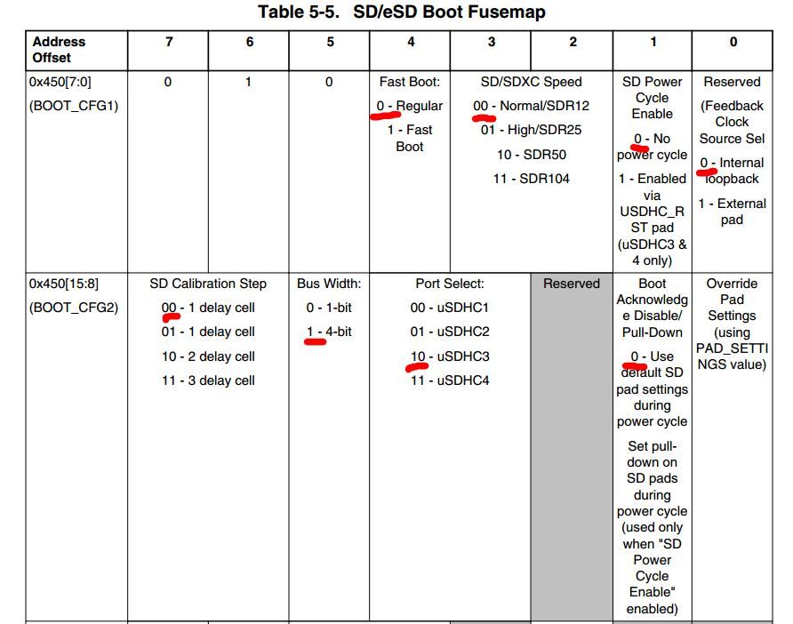

We are trying to bring up our custom board (based upon i.MX6 and the SABRE Lite schematic). We have made substantial progress, and have been able to flash to RAM and to the SD card using the mfgtool, but are having trouble now booting off of the SD card (specifically trying to boot off of the SD3 slot). We need to be able to change the boot mode to boot from the sd card.
Our board has pins BOOT_MODE0 and BOOT_MODE1, but no additional pins for setting up boot modes (as are available in the SABRE SD design) without flashing fuses. So our way forward is to flash fuses, but we want to make sure we are doing it correctly.
We have found two ways of flashing fuses:

AnsonHuang
Hi, Kyle
    I think the fuse you said is incorrect, please double check carefully.
OPTION1:
     I saw from our i.MX6Q SabreSD board, if want to boot from SD3, then below setting is needed:
BT_CFG1_7:  0
BT_CFG1_6:  1
BT_CFG1_5:  0
BT_CFG1_4:  X
BT_CFG2_4:  1
BT_CFG2_3:  0
     This BT_CFG means BOOT_CFG, in the fuse map, so it should be BOOT_CFG1 and BOOT_CFG2, it should be mapped to address 0x21bc450, but you said HW_OCOTP_CFG1, its address is 0x21bc420, it is for SJC_CHALL/UNIQUE_ID, it is incorrect. Please read 0x21bc450, it should be matching the current boot mode of your board, then try to modify it to SD3.
OPTION2:
Questions:
(1) Are we correct in trying thus to change “<index>” and “<value>” in order to boot from the SD card?
[Anson] Yes, you can just program the fuse using imxotp command in uboot, just make sure the index and value is correct.
(2) Is the fuse value 0x11204154 correct?
[Anson] I don't think so, as the fuse address you read is incorrect, you read OCOTP_CFG1, it is not BOOT_CFG1, you should read 0x21bc450, please double check. You can also get description of OCOTP_CFG1 in RM, 46.4.11, it is not for configuring boot mode!
(3) Is CFG1 the correct fuse bank for us to use, and if so what is the correct “<index>” hex value?
[Anson] index means the address minus 0x21bc400, and then divided by 0x10, for example, if the fuse address is 0x21bc450, the offset is '50', so the index is 5, if the address is 0x21bc420, then the index is 2. You can use imxotp read 2 to get the value of 0x21bc420, it should be equal to the value you got from OCOTP_CFG1.
9 返答(返信)

kylekenj
Got it to work flashing:
imxotp blow --force 5 0x3040
imxotp blow --force 6 0x10
in the u-boot using tables 5-7 and 8-15 in the reference manual.

kylekenj
From the fuse map we flashed 0x104 to index 5. We believe this sets the board to boot off the sd card and port sd3. Are we missing anything and does this sound correct. Thanks.

Thanks for your help. Just trying to make sure before I do anything. When I read in index 2 I get the same value as HW_OCOTP_CFG1. Index 5 is the value I should be looking at and there I get a value of 0x0. What should I change the value to? When I look at the RM, 46.4.11 is not there is says to ask a freescale rep for fuse map. Thanks again.
Kyle
8,472件の閲覧回数
Yuri
Please use Chapter 5 (Fusemap) of the Reference Manual.
