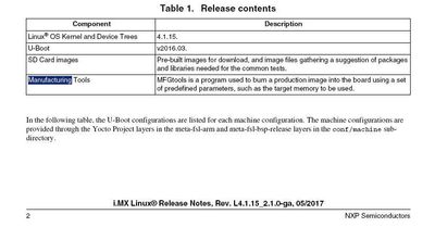

igorpadykov
Hi Teju
for L4.1.15 nxp supported mfg tools as described in Documentation
suggest to use releases which support uuu tool, description can be found
in linux documentation (Release Notes) on
https://www.nxp.com/design/software/embedded-software/i-mx-software/embedded-linux-for-i-mx-applicat...
igor

tejush44
Hi @igorpadykov
Thanks for the reply,
I have downloaded the mfgtool as per that document L4.1.15_2.0.0-ga_mfg-tools.
I have downloaded that in ubuntu, Can u please explain me how to use that i am new to this tool.
Actually i have booted board by SDcard. Please suggest me to boot image in nand or emmc flash.

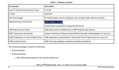

igorpadykov
Hi tejush44
reason may be wrong uuu/uboot/bsp versions, as they should be aligned as
described in Release Notes of each BSP available on
https://github.com/NXPmicro/mfgtools/releases
igor
