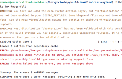

Mihan
Also I found I could not create sdcard type for the image:
We couldn't create this type for imx6dlsabresd, is that rigth?

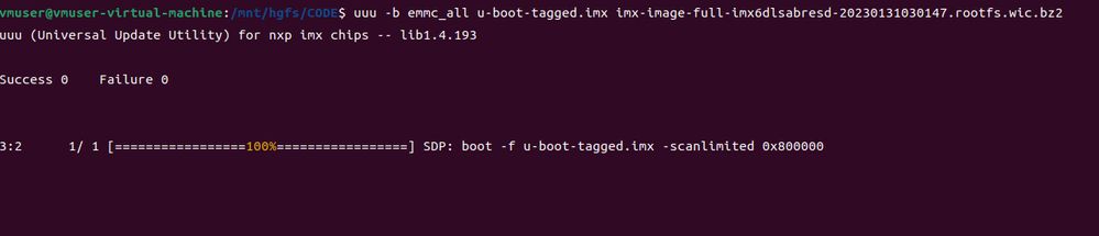

Mihan
Hi again.
I tried to use the command as follow to burn the image to imx6dlsabresd but fail
uuu -b emmc_all u-boot-tagged.imx imx-image-full-imx6dlsabresd-20230131030147.rootfs.wic.bz2
it will be frozen:20230131152846.jpg
What should I do for it?
15,672件の閲覧回数
edwardtyrrell
Senior Contributor I
Hi @Mihan
Make sure you local.conf has:
IMAGE_FSTYPES += " wic"
And try to get Yocto to build an uncompressed wic image. Some uses have found compressed wic's give problems with UUU.
Also, try:
uuu    -b     emmc_all      imx-image-full-imx6dlsabresd-20230131030147.rootfs.wic   (without the u-boot section and wic uncompressed)
Cheers.

Mihan
Hi again
I create an issue to uuu on github, and I got the message that the boot doesn't work and there is no output on serial port.
Do you know why?
BTW I could flash the old image (4.1.15) with mfgtool and there are some massages shown on serial port.

Mihan
Sorry
I added `IMAGE_FSTYPES += " wic"` then built again.But one thing I may need to explain is the storage on the device is only 4G and the wic file is 3.6G.
And I tried to flash with the uncompressed file without u-boot section, it didn't work, still frozen.
15,621件の閲覧回数
