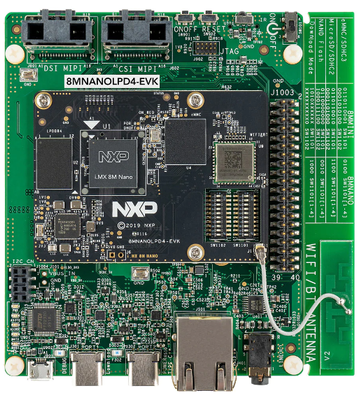

hi
First, I have set SW1101 to `1000`
then, I execute below.
uuu -b emmc_all imx-boot-imx8mnevk-sd.bin-flash_evk imx-image-multimedia-imx8mnevk.tar.zst
uuu (Universal Update Utility) for nxp imx chips -- libuuu_1.5.21-0-g1f42172
Success 0 Failure 1
5:12 1/ 1 [
HID(W):LIBUSB_ERROR_TIMEOUT ] SDPS: boot -scanterm -f imx-boot-imx8mnevk-sd.bin-flash_evk -scanlimited 0x800000
and serial port show below
U-Boot SPL 2023.04-lf_v2023.04+gaf7d004eaf (Jun 06 2023 - 14:59:40 +0000)
read error from device: 94f630 register: x!DDRINFO: start DRAM init
DDRINFO: DRAM rate 3200MTS
Training FAILED
plz comment for this.
thanks
Bryan

3,595 Views
bryan_hong
Senior Contributor I
I have attached evk board I using

Zhiming_Liu
I can flash with same steps.
There is two reasons about this error:
1. Your USB cable issue
2. EVK hardware issue.
3,525 Views

3,641 Views
Zhiming_Liu
Hi @bryan_hong
Please share the board photo.
