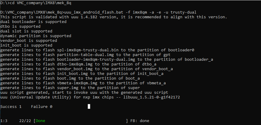

I built android image for i.MX 8 QM mek following Android User's Guide on Android 13.0.0.1.2.0.doc file. It's successful. Then I flash android image which was build to i.MX 8 QM mek and it had done.
But when I connect kit with display, it did not have signal and interface.
Because it did not have errors, so I can't know the reason of this.
Help me fix it, pls. Thanks!

->Please refer to Table 24 which shows the kernel command line (bootargs).
->Depending on the different booting/usage scenarios, one may need other kernel boot parameters set for bootargs.
->Please find the different boot arguments to enable MIPI, HDMI their resolution settings, please refer to that.
Please take a look at this link for more details.
https://www.nxp.com/docs/en/user-guide/ANDROID_USERS_GUIDE.pdf

i do following steps in android user's guide. But i did not change any parameter.
i run command: lunch mek_8q-userdebug,
then run ./imx-make.sh -j4 2>&1 | tee build-log.txt
and i saw the process is successful.
After have android image, i flashed it to imx 8 qm mek kit by UUU tool.
(I can not connect the imx 8 qm MEK with pc. I chose mode serial download or eMMC, and connect with pc by port micro-USB and USB type C. I used mobaXtern to connect via Serial, but an error is cannot access port (7-8-9-10). So I can't access U-boot command line or Kernel command line. )
Can you tell me how can i change parameter? and how can i connect board with pc via serial
