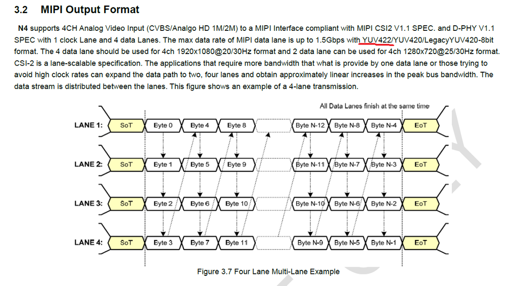

     I am meeting the same critical problem. Our product connects a Nextchip N4 to one MIPI-CSI2 port1, Nextchip N4 is converter from a AHD camera to mipi-csi2, support 4 channels, but I just used two channels for user switch camera, , same resolution 1920x1080@30 on both, due to i.mx8mq does not support virtual channels on MIPI CSI, so cannot make it work at the same time, so badly.
    The issue is : after system reboot, both channel1 or channel2 is working well with i.mx8mq mipi after system reboot, but when i switched N4 channel1 to channel2 without reboot imx8mq, MIPI-CSI2 then entered a crazy mode, always report "base address switching Change Err." and "crc error" on bit0:
MIPI CSI2 HC IRQ STATUS       0x10C = 0x9
     when do gst-launch-1.0 v4l2src again, it did "csihw_reset","csisw_reset","mxc_mipi_csi2_phy_reset", and I reset N4 also, but all ways could not recover MIPI CS2 to work, have to reboot boards. I am sure N4 side no problem. Any suggestion are welcome, thanks.
In addition, there are two hiden registers on i.mx8mq, but there is explaintion on imx8quadXplus reference manual, but i still cannot understand how to set it to allow channel2 pass, and ignore channel1.

weideding
What is the mipi-cs2 data format/sequence for 4 lanes? is there doc to explain it? below is from N4.
