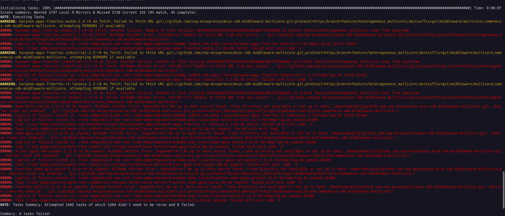

Hi @kenli & @Zhiming_Liu,
            found root cause now.
Due to BSP want checkout "e914909af2bf44fd651e3383ba0cd8cf5f0bda66" from branch 'feature/heterogeneous_multicore'
but "e914909af2bf44fd651e3383ba0cd8cf5f0bda66" not in branch 'feature/heterogeneous_multicore' now
10,021 Views

same issues on github.com/nxp-mcuxpresso/rpmsg-lite

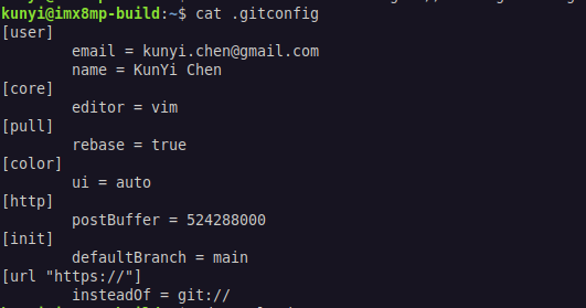

@kenli, the below is my operation steps and log
would you help me to check my steps is correct?

kunyichen
And when skip --runall=fetch option will get more error
full build log
kunyi@imx8mp-build:/real-edge$ bitbake nxp-image-real-time-edge
Loading cache: 100% |##########################################################################################################################################################################################################| Time: 0:00:00
Loaded 5546 entries from dependency cache.
Parsing recipes: 100% |########################################################################################################################################################################################################| Time: 0:00:02
Parsing of 3625 .bb files complete (3623 cached, 2 parsed). 5548 targets, 526 skipped, 3 masked, 0 errors.
NOTE: Resolving any missing task queue dependencies
Build Configuration:
BB_VERSION = "2.0.0"
BUILD_SYS = "x86_64-linux"
NATIVELSBSTRING = "universal"
TARGET_SYS = "aarch64-poky-linux"
MACHINE = "imx8mp-lpddr4-evk"
DISTRO = "nxp-real-time-edge"
DISTRO_VERSION = "2.5"
TUNE_FEATURES = "aarch64 armv8a crc crypto"
TARGET_FPU = ""
meta
meta-poky = "HEAD:24a3f7b3648185e33133f5d96b184a6cb6524f3d"
meta-oe
meta-multimedia
meta-python = "HEAD:744a4b6eda88b9a9ca1cf0df6e18be384d9054e3"
meta-freescale = "HEAD:c82d4634e7aba8bc0de73ce1dfc997b630051571"
meta-freescale-3rdparty = "HEAD:5977197340c7a7db17fe3e02a4e014ad997565ae"
meta-freescale-distro = "HEAD:d5bbb487b2816dfc74984a78b67f7361ce404253"
meta-bsp
meta-sdk
meta-ml
meta-v2x = "HEAD:f3f6777cc016be11084e98c9986f09791c92a63f"
meta-nxp-demo-experience = "HEAD:52eaf8bf42f8eda2917a1c8c046003c8c2c8f629"
meta-chromium = "HEAD:e232c2e21b96dc092d9af8bea4b3a528e7a46dd6"
meta-clang = "HEAD:c728c3f9168c8a4ed05163a51dd48ca1ad8ac21d"
meta-gnome
meta-networking
meta-filesystems = "HEAD:744a4b6eda88b9a9ca1cf0df6e18be384d9054e3"
meta-qt6 = "HEAD:ed785a25d12e365d1054700d4fc94a053176eb14"
meta-cpan = "HEAD:3d82a95da95395c20ae13a89dd7de0cebcc27bfa"
meta-virtualization = "HEAD:9482648daf0bb42ff3475e7892542cf99f3b8d48"
meta-rtos-industrial = "HEAD:6d631c518b25d69e448e7d1ac09db349c11b691b"
meta-nxp-harpoon = "HEAD:811000d1289c45f57ab321426c92c882a6d7ffbe"
meta-nxp-avb = "HEAD:99250391a345821b3f55497c68b15d6cd974a19a"
meta-real-time-edge = "HEAD:c50b00423bc3e6fe6a8e39e15b032041544454e7"
Initialising tasks: 100% |#####################################################################################################################################################################################################| Time: 0:00:07
Sstate summary: Wanted 3747 Local 9 Mirrors 0 Missed 3738 Current 155 (0% match, 4% complete)
NOTE: Executing Tasks
WARNING: harpoon-apps-freertos-audio-2.3-r0 do_fetch: Failed to fetch URL git://github.com/nxp-mcuxpresso/mcux-sdk-middleware-multicore.git;protocol=https;branch=feature/heterogeneous_multicore;destsuffix=git/middleware/multicore;name=mcux-sdk-middleware-multicore, attempting MIRRORS if available
ERROR: harpoon-apps-freertos-audio-2.3-r0 do_fetch: Fetcher failure: Unable to find revision e914909af2bf44fd651e3383ba0cd8cf5f0bda66 in branch feature/heterogeneous_multicore even from upstream
ERROR: harpoon-apps-freertos-audio-2.3-r0 do_fetch: Bitbake Fetcher Error: FetchError('Unable to fetch URL from any source.', 'git://github.com/nxp-mcuxpresso/mcux-sdk-middleware-multicore.git;protocol=https;branch=feature/heterogeneous_multicore;destsuffix=git/middleware/multicore;name=mcux-sdk-middleware-multicore')
ERROR: Logfile of failure stored in: /real-edge/build-imx-real-time-edge/tmp/work/imx8mp_lpddr4_evk-poky-linux/harpoon-apps-freertos-audio/2.3-r0/temp/log.do_fetch.62444
ERROR: Task (/real-edge/sources/meta-nxp-harpoon/recipes-bsp/harpoon-apps/harpoon-apps-freertos-audio_2.3.bb:do_fetch) failed with exit code '1'
WARNING: harpoon-apps-freertos-industrial-2.3-r0 do_fetch: Failed to fetch URL git://github.com/nxp-mcuxpresso/mcux-sdk-middleware-multicore.git;protocol=https;branch=feature/heterogeneous_multicore;destsuffix=git/middleware/multicore;name=mcux-sdk-middleware-multicore, attempting MIRRORS if available
ERROR: harpoon-apps-freertos-industrial-2.3-r0 do_fetch: Fetcher failure: Unable to find revision e914909af2bf44fd651e3383ba0cd8cf5f0bda66 in branch feature/heterogeneous_multicore even from upstream
ERROR: harpoon-apps-freertos-industrial-2.3-r0 do_fetch: Bitbake Fetcher Error: FetchError('Unable to fetch URL from any source.', 'git://github.com/nxp-mcuxpresso/mcux-sdk-middleware-multicore.git;protocol=https;branch=feature/heterogeneous_multicore;destsuffix=git/middleware/multicore;name=mcux-sdk-middleware-multicore')
ERROR: Logfile of failure stored in: /real-edge/build-imx-real-time-edge/tmp/work/imx8mp_lpddr4_evk-poky-linux/harpoon-apps-freertos-industrial/2.3-r0/temp/log.do_fetch.62441
ERROR: Task (/real-edge/sources/meta-nxp-harpoon/recipes-bsp/harpoon-apps/harpoon-apps-freertos-industrial_2.3.bb:do_fetch) failed with exit code '1'
WARNING: harpoon-apps-freertos-rt-latency-2.3-r0 do_fetch: Failed to fetch URL git://github.com/nxp-mcuxpresso/mcux-sdk-middleware-multicore.git;protocol=https;branch=feature/heterogeneous_multicore;destsuffix=git/middleware/multicore;name=mcux-sdk-middleware-multicore, attempting MIRRORS if available
ERROR: harpoon-apps-freertos-rt-latency-2.3-r0 do_fetch: Fetcher failure: Unable to find revision e914909af2bf44fd651e3383ba0cd8cf5f0bda66 in branch feature/heterogeneous_multicore even from upstream
ERROR: harpoon-apps-freertos-rt-latency-2.3-r0 do_fetch: Bitbake Fetcher Error: FetchError('Unable to fetch URL from any source.', 'git://github.com/nxp-mcuxpresso/mcux-sdk-middleware-multicore.git;protocol=https;branch=feature/heterogeneous_multicore;destsuffix=git/middleware/multicore;name=mcux-sdk-middleware-multicore')
ERROR: demo-hello-world-2.12.0-r0 do_unpack: Bitbake Fetcher Error: UnpackError('No up to date source found: clone directory not available or not up to date: /download/git2/github.com.nxp-mcuxpresso.mcux-sdk-middleware-multicore.git; shallow clone not enabled', 'git://github.com/nxp-mcuxpresso/mcux-sdk-middleware-multicore.git;protocol=https;nobranch=1;destsuffix=git/middleware/multicore;name=mcux-sdk-middleware-multicore')
ERROR: Logfile of failure stored in: /real-edge/build-imx-real-time-edge/tmp/work/imx8mp_lpddr4_evk-poky-linux/harpoon-apps-freertos-rt-latency/2.3-r0/temp/log.do_fetch.62448
ERROR: Logfile of failure stored in: /real-edge/build-imx-real-time-edge/tmp/work/armv8a-poky-linux/demo-hello-world/2.12.0-r0/temp/log.do_unpack.62483
ERROR: Task (/real-edge/sources/meta-nxp-harpoon/recipes-bsp/harpoon-apps/harpoon-apps-freertos-rt-latency_2.3.bb:do_fetch) failed with exit code '1'
ERROR: Task (/real-edge/sources/meta-rtos-industrial/recipes-kernel/mcux-kernel/demo-hello-world.bb:do_unpack) failed with exit code '1'
ERROR: soem-gpio-pulse-2.12.0-r0 do_unpack: Bitbake Fetcher Error: UnpackError('No up to date source found: clone directory not available or not up to date: /download/git2/github.com.nxp-mcuxpresso.mcux-sdk-middleware-multicore.git; shallow clone not enabled', 'git://github.com/nxp-mcuxpresso/mcux-sdk-middleware-multicore.git;protocol=https;nobranch=1;destsuffix=git/middleware/multicore;name=mcux-sdk-middleware-multicore')
ERROR: Logfile of failure stored in: /real-edge/build-imx-real-time-edge/tmp/work/armv8a-poky-linux/soem-gpio-pulse/2.12.0-r0/temp/log.do_unpack.62484
ERROR: Task (/real-edge/sources/meta-rtos-industrial/recipes-kernel/mcux-kernel/soem-gpio-pulse.bb:do_unpack) failed with exit code '1'
ERROR: driver-gpio-led-output-2.12.0-r0 do_unpack: Bitbake Fetcher Error: UnpackError('No up to date source found: clone directory not available or not up to date: /download/git2/github.com.nxp-mcuxpresso.mcux-sdk-middleware-multicore.git; shallow clone not enabled', 'git://github.com/nxp-mcuxpresso/mcux-sdk-middleware-multicore.git;protocol=https;nobranch=1;destsuffix=git/middleware/multicore;name=mcux-sdk-middleware-multicore')
ERROR: Logfile of failure stored in: /real-edge/build-imx-real-time-edge/tmp/work/armv8a-poky-linux/driver-gpio-led-output/2.12.0-r0/temp/log.do_unpack.62485
ERROR: Task (/real-edge/sources/meta-rtos-industrial/recipes-kernel/mcux-kernel/driver-gpio-led-output.bb:do_unpack) failed with exit code '1'
ERROR: freertos-soem-gpio-pulse-2.12.0-r0 do_unpack: Bitbake Fetcher Error: UnpackError('No up to date source found: clone directory not available or not up to date: /download/git2/github.com.nxp-mcuxpresso.mcux-sdk-middleware-multicore.git; shallow clone not enabled', 'git://github.com/nxp-mcuxpresso/mcux-sdk-middleware-multicore.git;protocol=https;nobranch=1;destsuffix=git/middleware/multicore;name=mcux-sdk-middleware-multicore')
ERROR: Logfile of failure stored in: /real-edge/build-imx-real-time-edge/tmp/work/armv8a-poky-linux/freertos-soem-gpio-pulse/2.12.0-r0/temp/log.do_unpack.62490
ERROR: Task (/real-edge/sources/meta-rtos-industrial/recipes-kernel/mcux-kernel/freertos-soem-gpio-pulse.bb:do_unpack) failed with exit code '1'
ERROR: freertos-hello-2.12.0-r0 do_unpack: Bitbake Fetcher Error: UnpackError('No up to date source found: clone directory not available or not up to date: /download/git2/github.com.nxp-mcuxpresso.mcux-sdk-middleware-multicore.git; shallow clone not enabled', 'git://github.com/nxp-mcuxpresso/mcux-sdk-middleware-multicore.git;protocol=https;nobranch=1;destsuffix=git/middleware/multicore;name=mcux-sdk-middleware-multicore')
ERROR: Logfile of failure stored in: /real-edge/build-imx-real-time-edge/tmp/work/armv8a-poky-linux/freertos-hello/2.12.0-r0/temp/log.do_unpack.62486
ERROR: Task (/real-edge/sources/meta-rtos-industrial/recipes-kernel/mcux-kernel/freertos-hello.bb:do_unpack) failed with exit code '1'
NOTE: Tasks Summary: Attempted 1405 tasks of which 1384 didn't need to be rerun and 8 failed.
Summary: 8 tasks failed:
Summary: There were 3 WARNING messages.
Summary: There were 11 ERROR messages, returning a non-zero exit code.

kunyichen
still failed when to change my .gitconfig after
the message display to fetch incorrect uri,
so maybe the BSP have some bugs?
and my .gitconfig now
10,176 Views
