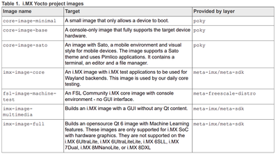

I believe (cannot remember), I built the image with imx-image-core which should be OK to do it. For just in case, I have actually done with other image name,,,, is there any image name that gst-launch-1.0 with wayland would not work (i.e. core-image-minimal)?

Hello @Kenji-EU-NEC
I hope you are doing well.
You can check the Yocto project user's guide in table Table 1. i.MX Yocto project images:
Also, you can refer to the Images Yocto documentation.
Salas.
