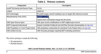

Hi tejas-volansys
from log: "uuu_version 1.2.39",
for linux-5.4.24_2.1.0 all versions of software components should
be carefully aligned according to   i.MX Linux Release Notes
igor

We have tried with uuu version 1.3.191 and now flash is getting stuck after showing 100%. Below is the log for the same
Note: We were using uuu version 1.3.171 previously. I think "uuu_version 1.2.39" is hard-coded in "uuu/emmc_burn_loader.lst" file
