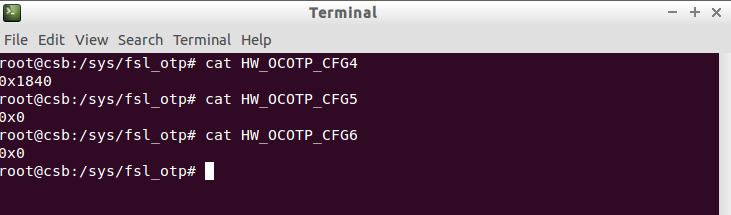

In u-boot, downloaded by usb serial port, we set by commands below the fusemap:
1 - fuse override 0 6 0x5860
2- fuse override 0 5 0x0010
We have already stored the boot and kernel partition in the eMMC (SD4 ), we set the BOOT MODE as 00 (Boot from fuses).
After "reset" by command in u-boot I aspect that the boot coming from eMMC, but really doesn't start.
Have any suggest ?
Thank in advanced

We check  the efuses value by emulator after command "fuse override 0 5 0x00005860" in the register OCOTP_CONFIG4 and it was correct, but after command u-boot reset  as you suggest on the register (SRC_SBMR1,2) we not found the expected value.
Then if you look at the link imx6sx U-BOOT from eMMC rev 5.0 , we program the fuses by command "fuse prog 0 5 0x00005860", and now we read the expected value inSRC_SMBR1,2 but as explain in the new request the board doesn't boot from eMMC.

We try to set the fuses also in the demoboard of NXP (6SX-SABRE-SDB RevC), with the same result:
1- as you see picture above the configuration fuses is set to boot from SD by SD4, if I use MODE 0/1 to zero (boot from fuses mode )
    the CPU doesn't boot
2- if I set the MODE 0/1 to 2 "boot from Intenal Boot" and set the
                             SW10 - 00000000
                             SW11 - 00111000
                             SW12 - 01000000
In this setting the CPU boot correctly from SD
We analyze signal in the first case and we don't see the SD4_CLK and SD4_CMD move ......
We read also SRC_SMBR1,2 and the values are correct.
It seems that the boot from fuses doesn't work.
Any suggestion ?

I understand that the boot mode is 00 (Boot from Fuses), what about   the BT_FUSE_SEL fuse has been set ?
1,606 Views
abelussi
We leave to zero
1,606 Views
jamesbone
In Boot_From_Fuses mode (00b), BT_FUSE_SEL is used by the boot ROM to control the boot flow.  With BT_FUSE_SEL=0, the boot ROM goes straight into the serial downloader.  With BT_FUSE_SEL=1, the boot ROM attempts to boot from the boot device selected in the boot config fuses.
The intent is to allow a board to be built with a blank i.MX6 and blank memory.  With the board strapped to boot from fuses mode, the device will go straight into serial downloader mode the first time it is booted.  Production equipment would then use this mode to load an image into memory and burn BT_FUSE_SEL.  The next time the board boots, it will run the image.
1,606 Views
