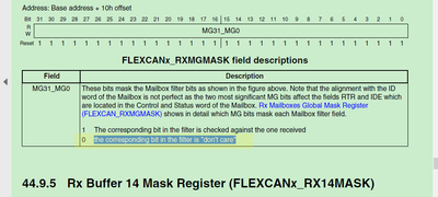

Hi @arjunsagar ,
   Can you define your filtered unique ID or not?
   If yes, an  efficient way for you, eg, to the ID, you need to check all the bit, this is used to filter one uique ID. But, if to some ID bit, you don't check it, then it means you can use two uique ID pass the filter, then don't check 2 bits, it is 4 unique ID , 3 bits, it is 8 uique ID, etc.
   I mean this:
Then, to your 13, you may use 3 bit ignore for 8 ID in one MB, and 2 bit ignore for 4 ID,  and one normal MB. So, you can configure 3 MB, if you can define your received ID. But if the ID totally can't share the bit, then you may define it one by one.
Wish it helps you!
Kerry
