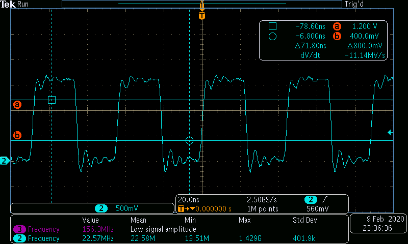

I am trying to use an external clock of 22579200 Hz on CLK_EXT3 Ball AG11 of an iMX8MM
This clock is supposed to provide the clock to SAI3 and SPDIF modules
Unfortunately the board freeze once it try to change the clock parent

Hi Patrick,
I have applied the following patch in order to use CLK_EXT3 as SAI3 source in a i.MX8MM EVK:
http://code.bulix.org/vst00z-1125422
Kernel booted without any hang.
Please note that I have disabled the camera because on i.MX8MM EVK the GPIO1_IO06 pin is used as camera reset originally. Make sure there is no pin conflit on your dts as well.
Another experiment we did was to boot the kernel without supplying the EXT_CLK3 clock. In this case the kernel hangs and as soon as we turn on the external clock generator, then the boot proceeds.
So we see the same behavior in U-Boot and kernel: the clock switch is successful as long as EXT_CLK3 is present. If it is not present, then the system hangs.

we also use EXT_CLK3 on imx8mm for our SAI clock. We have done the following:
  • EXT_CLK3 must be available otherwise system freezes
    For our setup (EXT_CLK3 is generated in another FPGA) we switch to the internal clock
    for boot and during FPGA reconfiguration and then switch back to EXT_CLK3 after clock is locked.
  • We have the following IOMUX in the the hog group - not in the sai pinctrl definition
    MX8MM_IOMUXC_GPIO1_IO06_CCMSRCGPCMIX_EXT_CLK3 0x00000019
  • We have patched the fsl-imx8mm.dtsi for definition of correct EXT-CLK3 frequency.
    Otherwise the clock is assumed to be 133 MHz

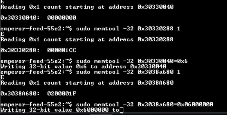

Aurelien_BOUIN
Hi Igor,
Thank you for pointing me to this problem which is a bit different, the M4 hang when the linux boot because the linux is touching some registers used by the M4
In my case it is a lot more simpler, what I want to do is just use EXT_CLK3 as MCLK for SAI3 & SPDIF1 modules
I have try several things :
1. I have tested to modify the code into drivers/clk/imx/clk-imx8mm.c, adding thoses lines :
pr_info("i.MX8MM clock driver before setting CLK_EXT3");
clk_set_parent(clks[IMX8MM_CLK_SAI3], clks[IMX8MM_CLK_EXT3]);
clk_set_parent(clks[IMX8MM_CLK_SPDIF1], clks[IMX8MM_CLK_EXT3]);
pr_info("i.MX8MM clock driver after setting CLK_EXT3");
#just before :
imx_register_uart_clocks(uart_clks);
pr_info("i.MX8MM clock driver init done\n");
Unfortunately the iMX is hanging directly ... :

The iMX8 boot without any problem, and I can play sound without troubles
I then check the pin muxing which actually was correct
Pages RM 1330 : IOMUXC_SW_MUX_CTL_PAD_GPIO1_IO06
sudo memtool -32 0x30330040 1
return : 00000006
=>ALT6 => CCM_EXT_CLK3
Pages RM 1492 : IOMUXC_SW_PAD_CTL_PAD_GPIO1_IO06
sudo memtool -32 0x303302A8 1

Hello Fabio,
Here is an attached screenshot of our clock going into GPIO6:
GPIO6 after rework and after setting sudo memtool -32 0x30330040=0x6
So we know our clock is hooked up and is getting a clean signal. Then here is a step by step setting of the values so you can see when it hangs:
As far as we can tell, the only difference between our setup and yours is that we are running our GPIO on 3.3V logic and yours is 1.8V.
Please advise.
Grant

gkilmer
Fabio,
I tried doing the same thing but this time lowering the clock signal down to 1.8V logic. See here:
Probing GPIO6:
And here is the commands 1 by 1:
Still no luck! NVCC_GPIO1 is 3.3V on our board. This seems to be the only difference in our setups.
Grant
