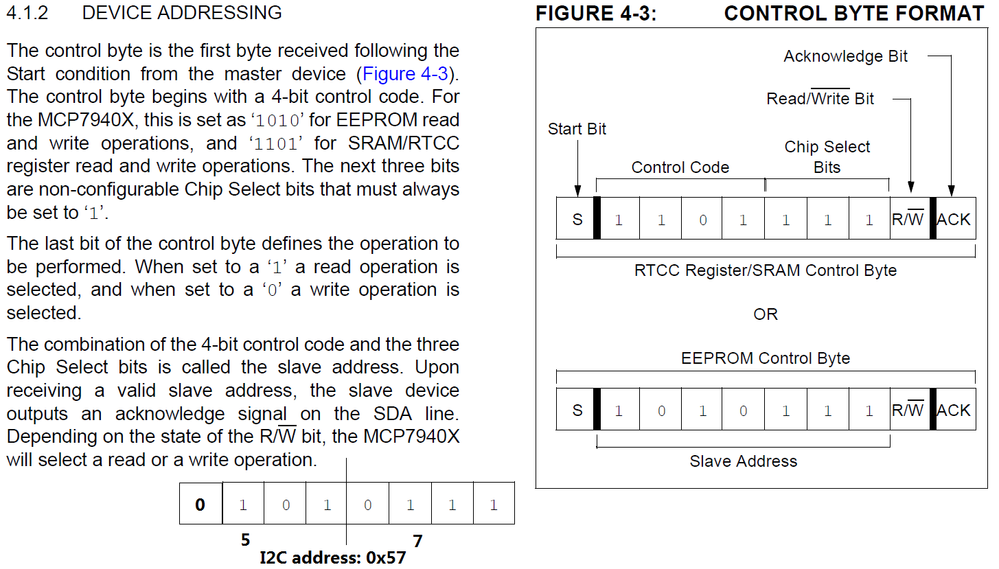

I've found the issue. For some reason the addressing to this device is 0x6F. If you look at the output of my i2c detect tool it shows it communicates with 0x6F address!
root@imx6sx-miltouch:~# i2cdetect -y 2
0 1 2 3 4 5 6 7 8 9 a b c d e f
00: -- -- -- -- -- -- -- -- -- -- -- -- --
10: -- -- -- -- -- -- -- -- -- -- -- -- -- -- -- --
20: -- -- -- -- -- -- -- -- -- -- -- -- -- -- -- --
30: -- -- -- -- -- -- -- -- -- -- -- -- -- -- -- --
40: -- -- -- -- -- -- -- -- -- -- -- -- -- -- -- --
50: -- -- -- -- -- -- -- -- -- -- -- -- -- -- -- --
60: -- -- -- -- -- -- -- -- -- -- -- -- -- -- -- 6f
I changed the address to 6F for the rtc in the device tree and it worked. I guess the MCP data sheet is wrong or there was a program error for this specific device.
I appreciate all your help Weidong.

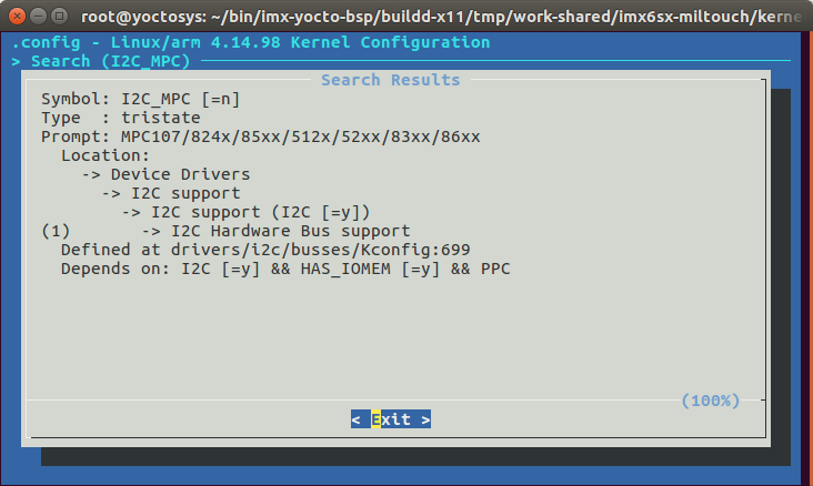

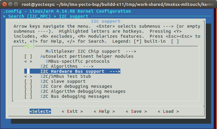

One issue I think might be more crucial than I thought, like I mentioned briefly about I2C_MPC driver, is that menuconfig is not allowing me to enable I2C_MPC. It shows up on search but when I select it on search, it doesn't go to the node to enable/disable. Please see pics below:
  Searching:
After I press 1:
It doesn't allow me to enable the I2C_MPC driver. How do I fix this?
EDIT: I believe this driver is for PowerPC and not the ARM A9 which is why I can't (and shouldn't need to) enable it.

weidong_sun
Hi Jon,
   I checked probe function of rtc-ds1307.c, there is  a case branch like below:
    case mcp794xx:
        /* make sure that the backup battery is enabled */
        if (!(regs[DS1307_REG_WDAY] & MCP794XX_BIT_VBATEN)) {
            regmap_write(ds1307->regmap, DS1307_REG_WDAY,
                     regs[DS1307_REG_WDAY] |
                     MCP794XX_BIT_VBATEN);
        /* clock halted?  turn it on, so clock can tick. */
        if (!(tmp & MCP794XX_BIT_ST)) {
            regmap_write(ds1307->regmap, DS1307_REG_SECS,
                     MCP794XX_BIT_ST);
            dev_warn(ds1307->dev, "SET TIME!\n");
            goto read_rtc;
when you loaded the driver, the case branch should be run, BUT according to your debug messages, source code in the branch wasn't run.  so please check which branch did it enter into!
In addition, probably you should ask rtc provider if MCP79400's driver is rtc-ds1307.c, According to the result I searched driver's name, rtc-ds1307.c should support the rtc chip.
Weidong

weidong_sun
Hi Jon,
I checked schematic, and connections to RTC, no issue was found.
And I checked RTC datasheet.
See datasheet of MCP7940, it seems that I2C address is 0x57,  check it, please!
Have a nice day!
B.R,
Weidong
