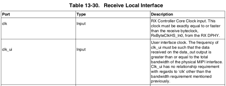

I'm porting a new MIPI 4-lane camera with bayer raw format to i.MX8M. But the image doesn't come out. I would like to know the relationship between pixel-rate and the settings of IMX8MQ_CLK_CSI1_PHY_REF_SRC and IMX8MQ_CLK_CSI1_CORE_SRC.
My camera been configured by follow settings:
  • The camera use 4-lanes to output Bayer RAW, DPHY=400MHz, 800Mbps.
  • The current pixel rate is: 1920x1080x30fps= 62,208,000 pixels/second.
  • The pixel format is RAW8, bitrate is: 62,208,000x8 = 497,664,000bps.
And for the MIPI-CSI2 receiver settings on i.MX8 (fsl-imx8mq.dtsi) is:
  • IMX8MQ_CLK_CSI1_CORE_DIV: 266MHz
  • IMX8MQ_CLK_CSI1_PHY_REF_DIV: 200MHz
  • IMX8MQ_CLK_CSI1_ESC_DIV: 66MHz
Q1. Should the PHY_REF clock be configured by 200MHz, 400MHz or 800MHz, when my camera is running at 400MHz/800Mbps?
Q2. Do you named 4-lane mode by Quad Pixel Mode?
Q3. To set the MIPI-CSI core_clk properly, it should be faster than the actual bitrate at single lane: 496,664,000/4 = 124,416,000bps, or just faster than 496,664,000bps?
Q4. According to this thread, I could  modify device tree and IMX8MQ_CLK_CSI1_CORE_SRC by clk-imx8mq.c?
I'm studying the reference manual, and got confused by clk, clk_ui descriptions and the device tree parameters:
Q5. Which clock is mapped to IMX8MQ_CLK_CSI1_CORE_SRC? the clk or clk_ui?
The current progress of my porting is I'm stuck at mx6s_capture.c, so I'm trying to find out if all the clock had been settle properly.
the IRQ handler been triggered several times, but no any image comes to buffer (mx6s_csi_frame_done() not been called ever). And there's no error bit been set in status register (CSI_CSISR).

I'm also checked the CSI_CSICR[31:16] for the "frame count", and the value is not zero, and not matched with the frame count inside the output_frame_count register of camera.

i.MX8M processor has 2 MIPI-CSI2 interfaces.
Each one support up to 4 data lanes
It supports from 80Mbps to 1.5Gbps data rate in high speed operation
Amd it supports 10Mbps data rate in low power operation
