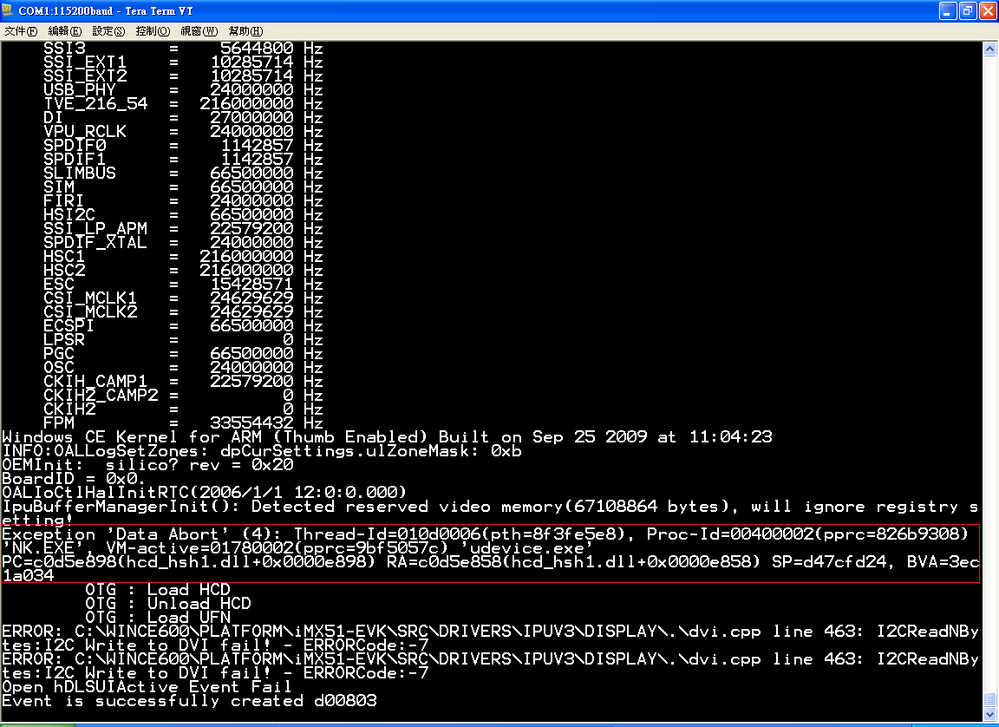

Dear all:
I  use the project solution(iMX51-EVK-Mobility) of imx51 evk bsp.
Sometimes the board boot up, it will show the error message as below:
It seems like High speed host 1 error, How do I fix the error and keep the usb function work?
Thank for your help,
Victor

Hi Victor
from log seems there are also IPU errors, so issue may be caused
by DDR faults, also recommended to check if ENGcm12051 patch
is implemented:
Updates and Patches (6)
Source code patch to provide SW workaround of erratum ENGcm12051.
Based on the i.MX51 Windows CE 6 1104 release.
i.MX51 Evaluation Kit|NXP
igor

Dear igorpadykov:
I update the source code with the patches, but still get the same problem.
Does any else solutions?
Thanks for your help,
Victor
