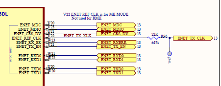

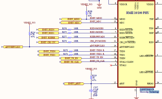

Dear sir,
We are using Processor dual lite part number MCIMX6U6AVM10AD  ball pin V22 (ENET_REF_CLK) connected to PHY (RMII)LAN8720AI-CP pin 5 XTAL1/CLKIN
Is the pin Enet_ref_clk (ball no V22) can be used as Enet_tx_clk for RMII mode?
I have attached the Pin configuration of Processor and PHY side.
please give quick suggestion.
Thanks & Regards,
Ramesha S P

Hi Ramesha
rmii clocks are well described on
https://community.nxp.com/thread/304346?commentID=331971#comment-331971
seems ball V22 (ENET_REF_CLK) could be used only for rgmii mode.
igor

rameshasp
Thanks for the reply,
Is there any way to Ethernet up in our design which i have attached in the above comments,
Ramesha S P

igorpadykov
V22 is not used in rmii mode. Signal ENET_REF_CLK (not pad
with name "ENET_REF_CLK") should be used - it is provided from
balls RGMII_TX_CTL or GPIO_16. Please look for more details in
i.MX6 System Development User’s Guide
https://www.nxp.com/docs/en/user-guide/IMX6DQ6SDLHDG.pdf

rameshasp
Hello sir,
Please see the above ENET_REF_CLK from the processor to PHY PIN 5(XTAL1/CLKIN).
