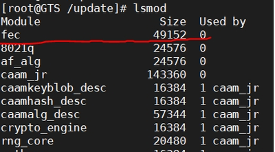

platform   :  I.MX6
kernel:       5.10
We have compiled the FEC driver configuration into a ko module, and everything is normal when loading insmod. However, in the rmmod driver module, the following error will be reported. What is this error (rmmod:ERROR:Module FEC is builtin)and how to solve it? Thank you
jerry2004_0-1696752690057.pngjerry2004_0-1696752690057.pngjerry2004_1-1696752726275.pngjerry2004_1-1696752726275.pngjerry2004_2-1696752756507.pngjerry2004_2-1696752756507.png

Hi @jerry2004
It seems that the fec is already a builtin kernel driver. what have you modified?
You can do dmesg to check and zcat /proc/config.gz.  also try to add print in remove of your driver.
