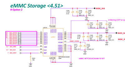

I'm having trouble flashing an mx6ull-evk.
We have modified it, soldering an eMMC memory.
I've tried with both mfgtool and uuu.
Last try was with uuu and images from L6.1.22. Logs at the end of the messages.
These error message looks like the more meaningful output I can find, but I cannot find a HW problem with the modification:
flash target is MMC:1
Card did not respond to voltage select! : -110
MMC card init failed!
How can we sort out this problem from here?
Can we get more information loading other u-boot? what is the meaning of error -110

Hello @V_Palacio
It seems that there is a voltage incompatibility:
This is from eMMC DNP of the IMX6ILL EVK, that is working at 3.3v, and your memory I could see works at 1.8v.
Best regards.

Hi @Manuel_Salas ,
After some changes trying to use an 1v8 eMMC, we have desisted and mounted a 3v3 eMMC.
https://www.micron.com/products/obsolete/obsolete-emmc/part-catalog/part-detail/mtfc8gakajcn-1m-wt
It works! It's now flashing the eMMC as I'm writing this post.

HI @Manuel_Salas ,
We have modified the CM, switching the I/O voltage from 3v3 to 1v8.
Desoldering R701 and soldering R702.
Still the same result, eMMC is no responding.
This is correct, or we need to change the eMMC for other reason?
We have measured VLDO_1V8 output, and looks like 3v3 to us.
