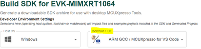

Hi I tried importing repository for i.MX RT1064 Evaluation Kit. I am using SDK_2_14_0_EVK-MIMXRT1064.zip . While importing the zip file in VSCode "Error: MCUXpresso SDK import failed. Selected file/folder is not a valid GCC ARM Embedded SDK". In the current supported devices in the MCUXpresso for Visual Studio Code webpage, Software details section > Supported Devices, I checked
  • i.MX-RT1064 is present.
    I have installed required softwares using MCUXpresso Installer.
    Can you help me with this?

Thank you for your reply. My host system is Ubuntu. So I installed MCU Xpresso IDE and tried to build example application. It was successful. Thank you for your help.

Hello @Jayadev,
Just for double check, could you please check that the SDK you are trying to import/add to VS Code is for ARM GCC/MCUXpresso for VS Code instead of MCUXpresso IDE?
You could download the ARM GCC/MCUXpresso for VS Code SDK here. In the Build SDK section choose Toolchain/IDE as ARM GCC/MCUxpresso for VS Code before clicking on Download SDK.
[Build SDK for EVK-MIMXRT1064]
