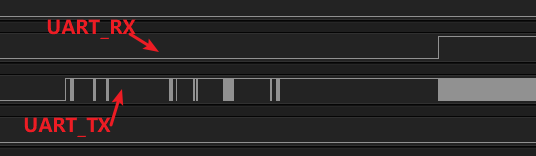

      The problem we encountered was that the system received serial port input during boot, which interrupted the normal startup process of the Uboot .

    We found that when the board power is grounded, there is no problem.  When the board power is not grounded, there will be a probability of the above problems.
      During the Uboot phase, the RX of the UART is at low level and UART_TX is at high level .  We add a pull-up resistor to the UART_RX to change its initial state to high.  Problem disappear.
      We couldn't find a reasonable explanation for this problem.We wanted to know what might causie this problem ? Have you ever encountered similar problems ?

   You mentioned "when the board power is grounded, there is no problem".
This looks like as noisy environment influence because of non-proper
board power supply unit. Please try to use other one.

As i found in the datasheet, the default status of UART_RX is "input with PD".
Whether it is ok if i set UART_RX to "input with PU" with external resistance?
5,408 次查看
Yuri
@viper1
    the default status of UART_RX "input with PD" relates to state after power on / reset.
In Your case U-boot is already working, meaning that UART configuring is performed by U-boot.
Yuri.
